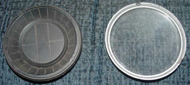

    There is a clear or od colered top plastic piece, that one has the cut for a screwdriver in it....then the cover piece with possibly the Jeep name on it and an o-ring on the back....illustration:
    The clear piece at right snaps onto the black piece at left...the left piece being the one with an o-ring on the back.
    Which are you tying to remove? I thought the clear one but maybe I am wrong....
