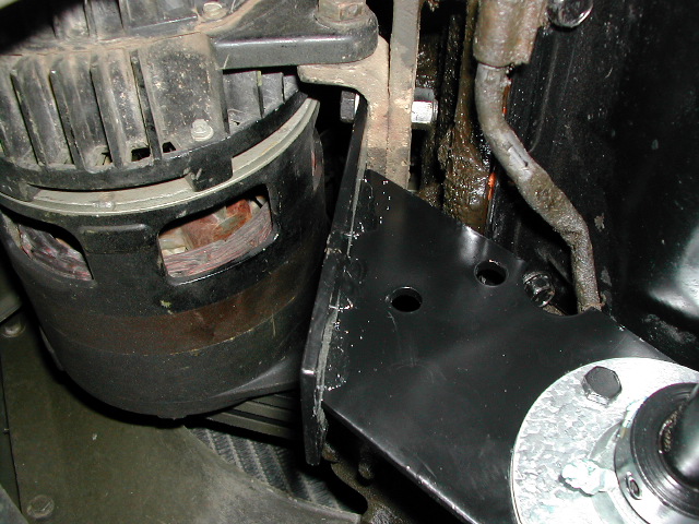

    G,Day all from down under just a silly question the mounting plate on the winch drive shaft would I be right in thinking that this is mounted to the alternator bracket useing the 2 bolts there or am I barking up the wrong tree ? just cant see where else it can go. Also I found the original serial numbers under the paint(3F4896) when I rubbed it back is there someplace I could go to find out about the work history of my truck ? eg: US Army transport Command or similar, I hope your new year has kicked off well best regards Kevin
    Yep...heres a pic to confirm...
