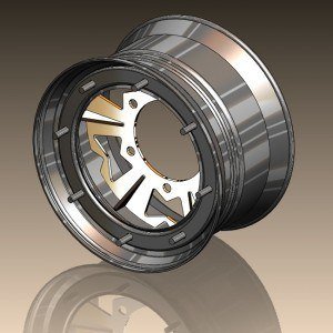

I am pretty sure I want to install modified H1 wheels on my truck so I can run tubeless radials. I have purchased a set of wheels to cut the centers out of. I plan to recenter the H1 wheels with these centers.
My first question is will my M715 centers fit the H1 wheels?
My next question is where do I find the H1 wheels?
I have read many old posts from several years ago. Many say the wheels are plentiful and inexpensive. I have yet to find where that is true.

M715 wheels are 16", Hummer wheels are 16.5
Are you thinking of leaving some material to make the difference up.....it is early and I could be missing something so my apologies in advance if thats the case.

I'm in the same boat in looking at taller tires for an M37 in order to 'cheat' the final drive ratios. Consider that you can buy custom wheels ordered in a 16.5 diameters by "X" width from MRW (Marsh Racing Wheels) with an M715 center & your choice of backspacing/offset and with/without a beadlock & mount the HMMWV tires. I'm really leaning towards a 40" tire on a 17"x9" MRW 1-pc wheel with an M37 'Budd' pattern center...
Do your own research before you decide a definite direction to take. I wouldn't dare attempt to talk you out of using the HMMWV wheels, but also consider that the 16.5" size does limit you in upgrading to taller tires in the future.
