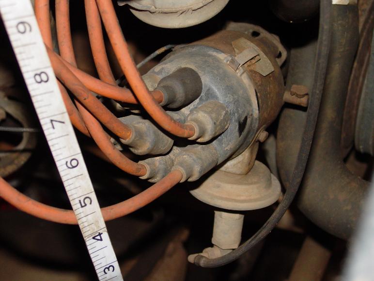

    I buy my caps for the stock distributor at Napa, for that application...wonder what you got a distributor for...the stock cap on the civvy dist is pretty small...I see I dont have the part number for the cap, but I walk in NAPA and ask for cap rotor point condensor for the 65 Gladiator 230 engine.

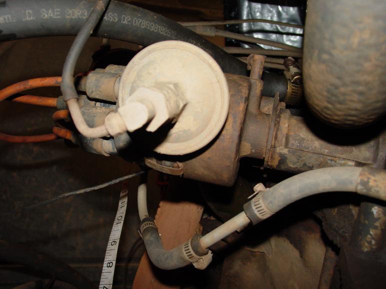

    Heres a couple pics of the distrib in my truck with the cap on...this is the only kind I have ever seen for the civvy setup...the mil setup is completely different but the cap is about the same size with the arm for the coil sticking out...The 2nd pics gives you the underneath view of the dist so you can compare to whatever you got from NAPA.
    Hope that helps,
    brute4c
