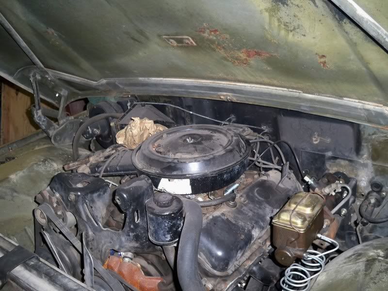

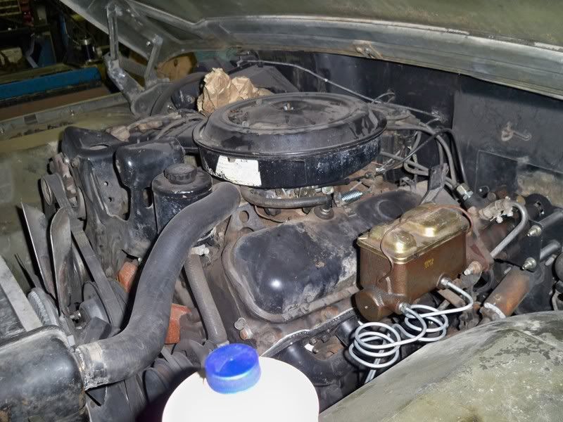

For the engine supports, are you going to finish welding around them, or are they strong enough just tack welded like that?

I will weld them fully when i know for sure its all where i want it and its all right. i hate welding stuff only to find out that i want to change something.
Proof positive, todays progress was to cut the stands off and move the engine over an 1/8th of an inch. Turns out the bolt holes i was using to measure from on the block were not symetrical as i supposed they were.
All is well now and the engine is centered. tomorrow is firewood cutting day, so doubtfull anything will happen till thursday

Been busy helping drew with his f-150, and his step son with his derby car. i also have been fighting with the idea of using a smal block instead of the BBC. i think that is the route i am headed, and eventually the big block will happen as everything i built was mocked with a big block. I also have a line on a NV4500 and i think i am going to get it this coming friday. i would have built my tranny crossmembers but i didn't want to make them for a 465 only to replace it a week later.

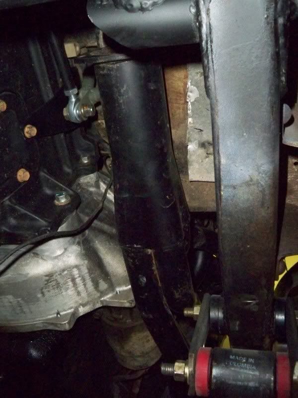

the begining of the engine stand gussets
all boxed in
a few more coming
primer. forgot to shoot the post weld pics
paint
int the truck
holding a SBC
plenty of room for a mech. fan now. lookes like there will be at least 2.5 inches between the clutch and the rad.
there are a few spots on the gussets where i could have spent a little more time with the grinder and made them look better, but it was hot, and i was ready to get that grinder out of my hands. so it is what it is
