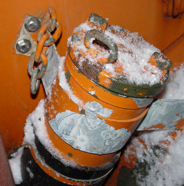

    Anyone figured a way to lock the fuel cap?
    With the price of fuel these days, our big tanks with easy access could be an easy target.

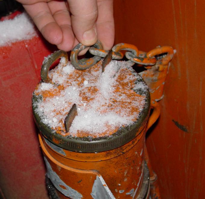

    Mine came with a short piece of chain welded to the iller neck and a single loop from the chain welded to the cap. I have seen others done this way...probably some motor pool addition. If one puts the chain in the right position and tightens the cap and locks everything, its good.
    Of course there is the drain plug on the bottom and that $100, roughly, fuel hose from the filler neck to the tank...easy for the crook...could be expensive for you.
    I see I have pics of the gas cap chain online:
