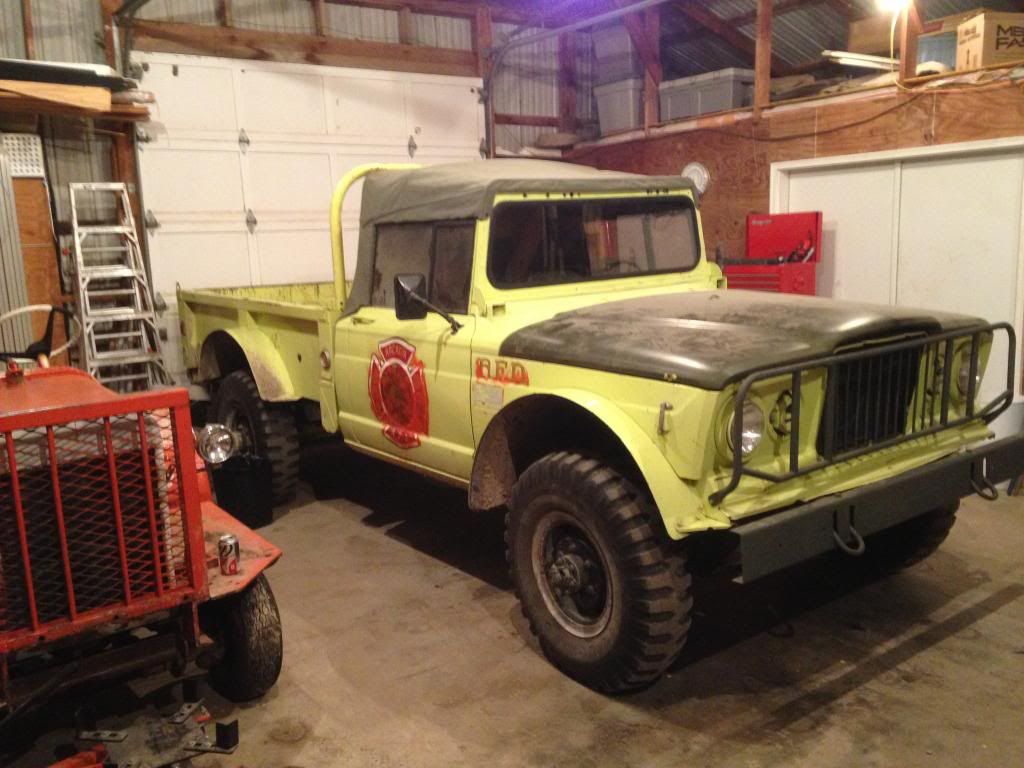

    So, a little history on this M715. I bought it on the GSA auction from the Kansas Forestry Service (yes, we have a forestry service in Kansas). They are the ones that supply the used military vehicles to the Kansas Fire Depts. This one came out of the Army in 1975 and spent until about 2008 in the Astoria, KS Fire Dept as a range truck. Here it is being pulled out of the Kansas Forestry Dept. in Manhattan, KS on 4-22-2011. (Slashed front tires and not running).
    And here it is in the driveway at home getting ready to be drug off to a new home. My little tractor could lift the front, but I had to go get my wife to hook up to the back of the tractor to drag it off since all the weight was on the front. She used my 1984 1 ton 4x4 chevy with a bigblock and it came right off.
    Put in a couple of used batteries around the place, fired it up, replaced all of the wheel cylinders, bled it out, and swapped on some new military treads. The top was trashed so pulled it off. Took off the front and rear platforms. Here she is doing a little work hauling brome hay to the shed with my sons working up a sweat.
    Here she is with the new hood, repro bumper (from vintage powerwagons) and a new top. That creature to the side is a 1940 something Clarke Trucktractor aircraft tug that was used to drag B29s around at the bomber training base in Greatbend, KS. My Dad had that in the shelterbelt, so it is one of the next projects in line. Number one son hit an owl between home and his girlfriends place in the M715 so it has a new windshield. Luckily the windshield was up.

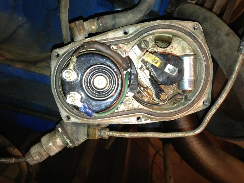

    Here's a picture of how I have things installed in the distributor.
    I'll go mess around with the points again.

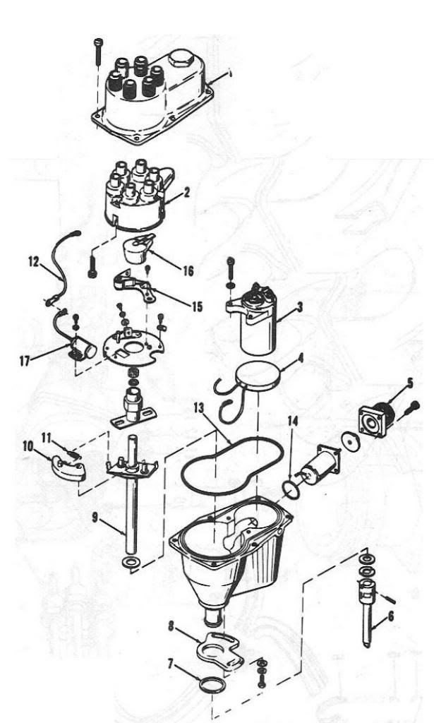

    Does it have a ballast resistor under the coil? (#4 in the diagram). Now that I have replaced the coil in my ignitor with a used coil (and it works fine) I wonder if my used coil is the newer type that has the built-in ballast. Just more confusion unfortunately! Maybe someone knows if the early and late coils are different lengths. Hopefully, the later coil with a built-in ballast will be too long? I do know that the NOS ignitor that I have has no ballast. I will check that out today.
