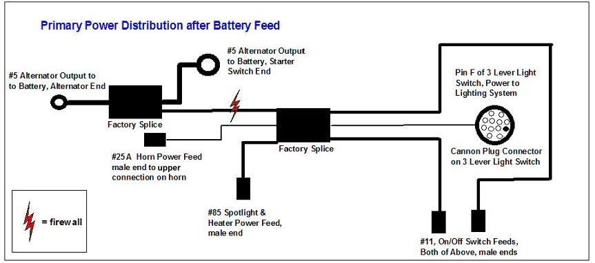

    The primary power distribution wiring looks like this:
    If you follow the big wire from the alternator toward the foot starter switch and find the block on that wire that is the factory splice...the smallest wire from that splice will go through the firewall and split at another splice. The middle wire on the opposite end of the splice from the wire that you followed to get to the splice is the one you want.

    Yep on pin F...that will safeguard the whole lighting system!
