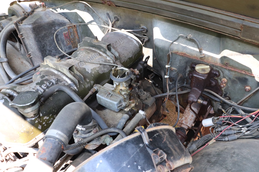

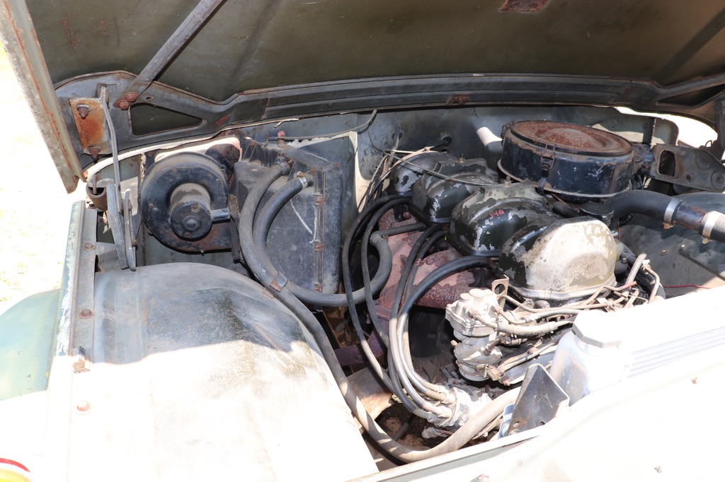

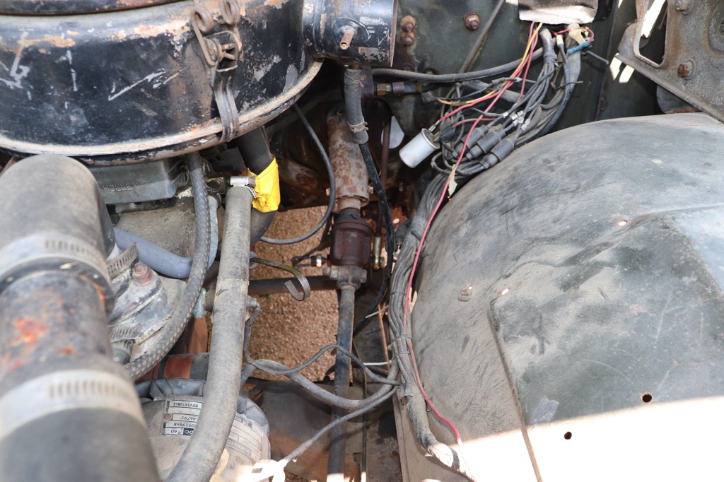

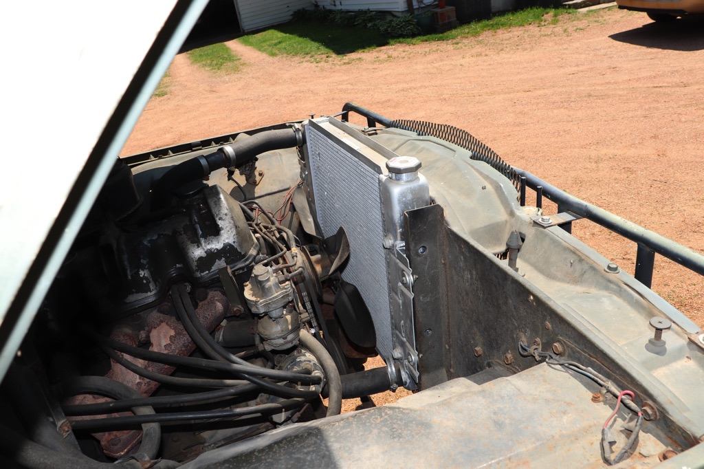

    Underhood: Pretty much stock but the wiring has definitely been modded...no distribution box or solid state flasher unit. Has aftermarket aluminum 2 thick cores radiator...a little narrower than the stock one but works for now for sure...have about 3/4 inch on each side of radiator to body...

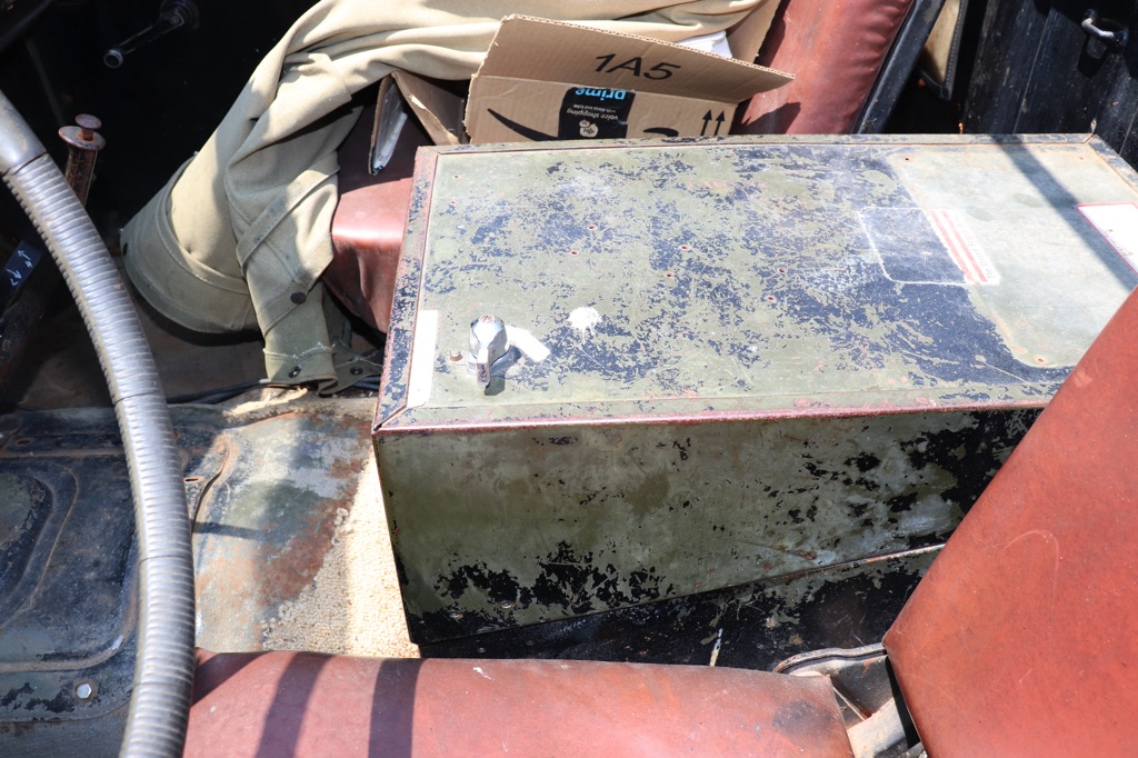

    Battery box has an on/off switch on the lid...handy.

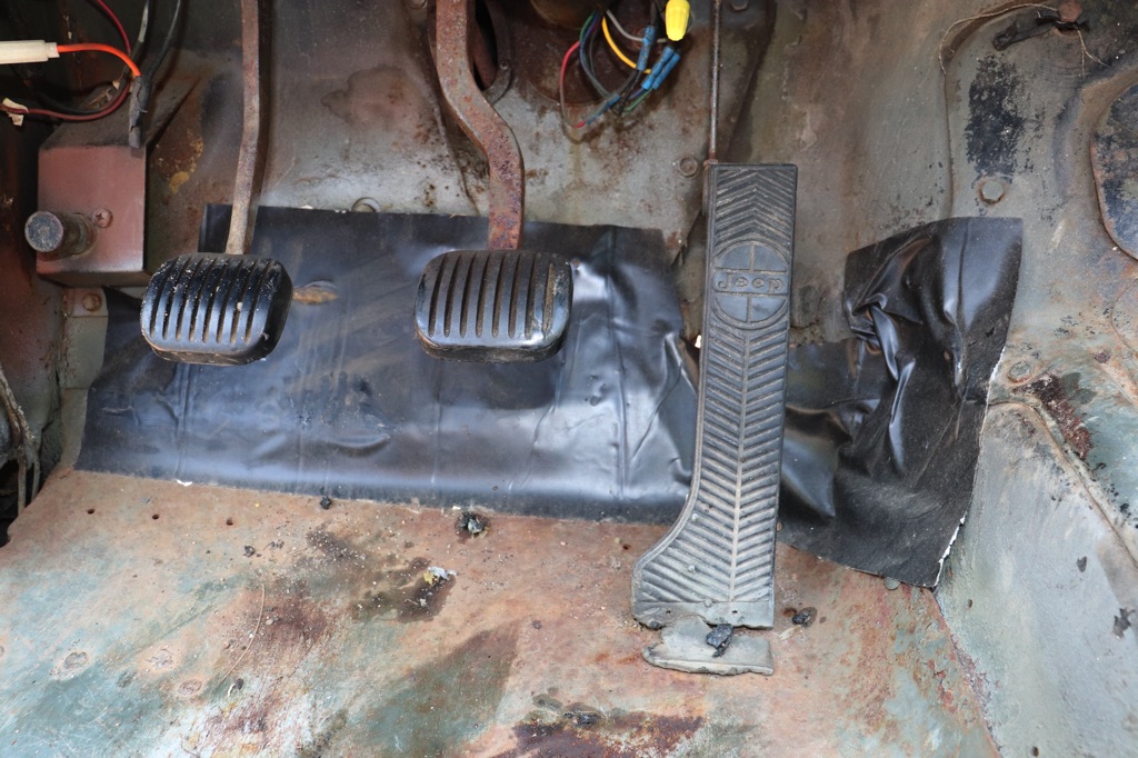

    Drivers floor was patched with a plate riveted to the transmission tunnel and I havent looked under the black tape...
    Note the fuse panel added to the drivers side by the door.
    One problem I have to work on is that the clutch linkage has been modded...the rod from the clutch pedal through the firewall isnt stock and if I push just the clutch pedal down, that rod binds on the brake pedal so I have to push the brake pedal to prevent that...though as mentioned above, no brakes at present.

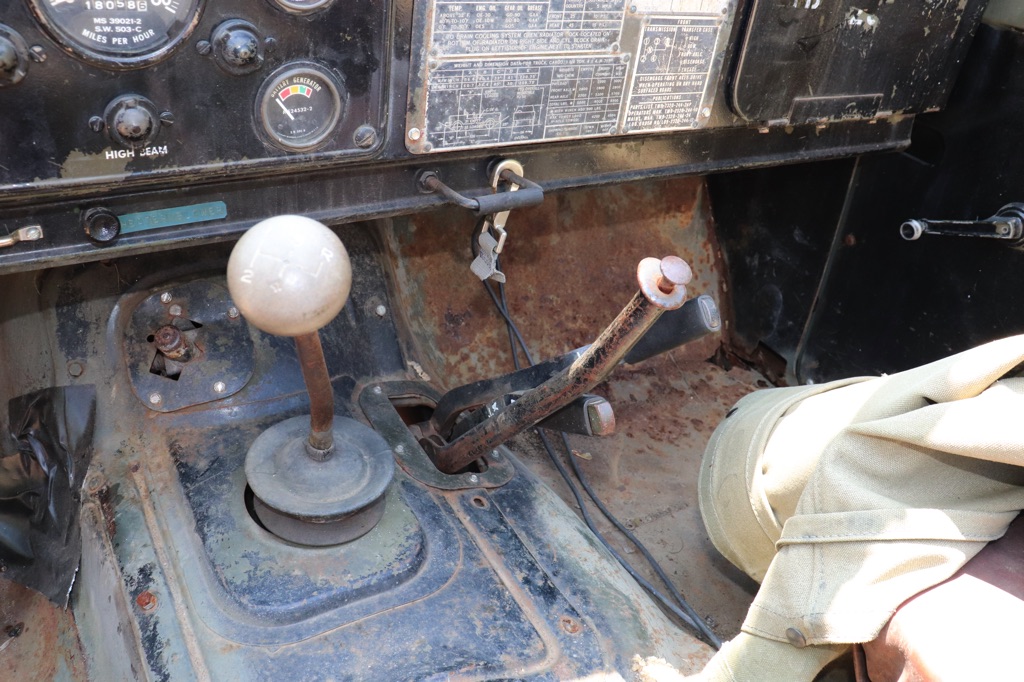

    All the stock shifters...ebrake works!

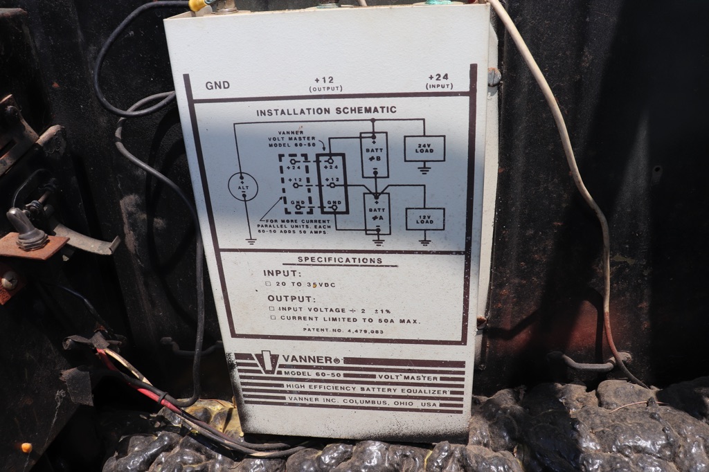

    There is a LARGE amount of great stuff foam...or something like it, taking up the rear bottom of the cab, inside and out...hopefully there is metl under there somewhere...its about 6 inches thick inside and sticks out several inches outside. You can also see the Battery Equalizer behind the drivers seat...gotta learn about that yet...

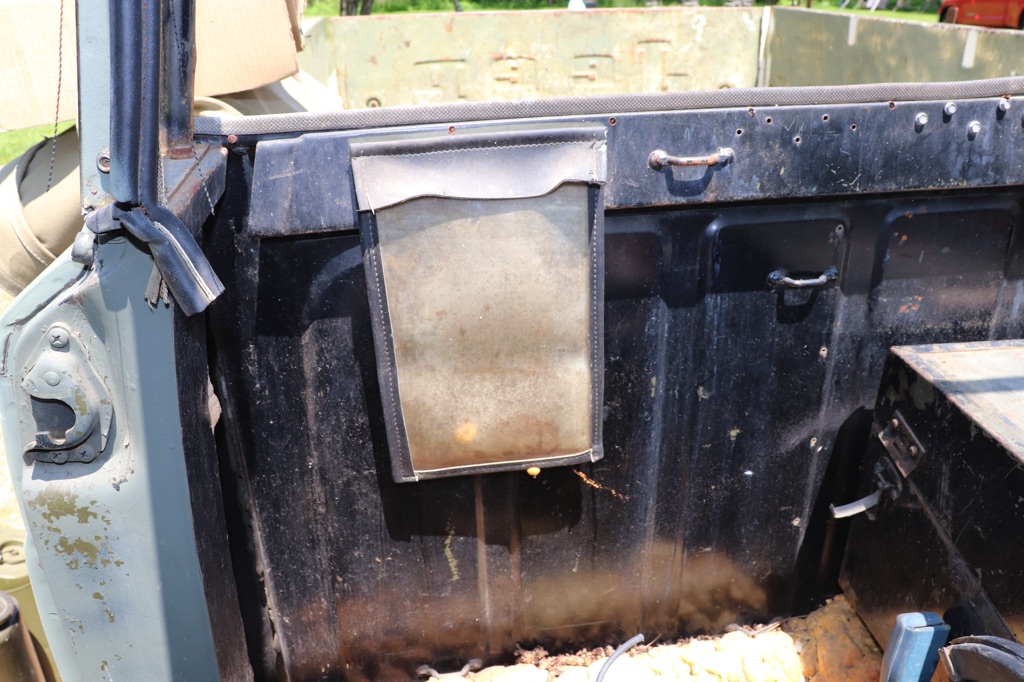

    Passenger floorboard needs repair...could be worse...behind the passenger seat, more foam...the pouch on the wall behind the seat...I wonder when that got added. You can see more little holes from the hardtop...

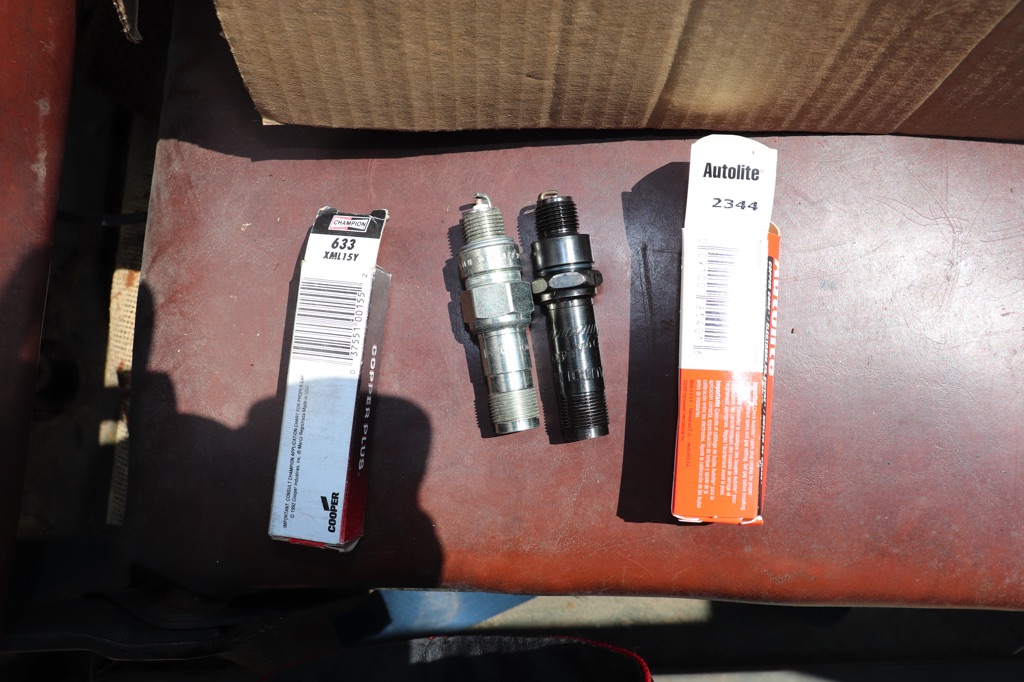

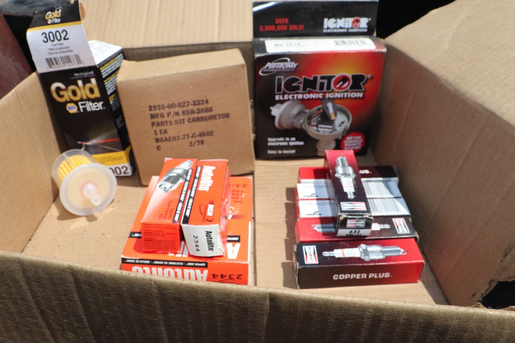

    Good news here...came with spare parts...2 different kinds of waterproof plugs...you can see the Autolite 2344 on the right and a Champion 633 on the left. Autolite has a narrower hex, longer tube for the plug wire and shorter reach into the cylinder. Those are correct for the M715...box of 6 brand new.
    The Champion plug is pretty different and I wonder what the application for those is...havent had time to check that out yet...
    There is also a spare inline fuel filter, carb kit and an electronic ignition conversion kit!
