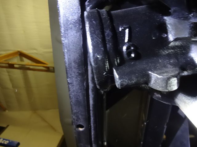

    Well I went and looked at my truck and I could see the numbers up near the front end of the box. Like this..
