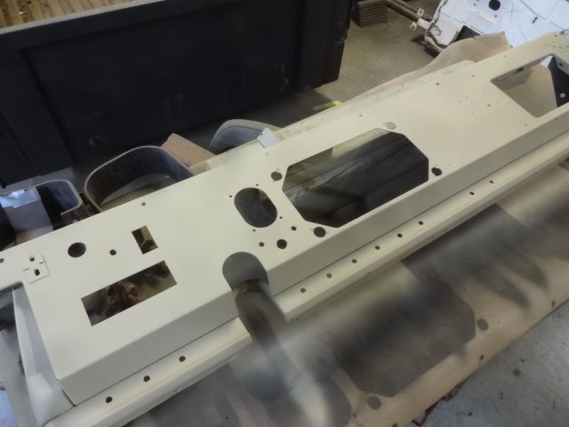

After days of sanding it was getting hard to see what still needed it. I decided to spray it out. I got the dash and cab done. It revealed the last remaining work. I will try to do that today. Outside temps allow me to heat the shop to the needed temperature to paint. Soon that will be a challenge.
The cab had 4 or 5 layers of paint on it. Lots and lots of deep paint cracks. I sanded for almost a week. It looks great. I put new seam sealer all over it.
