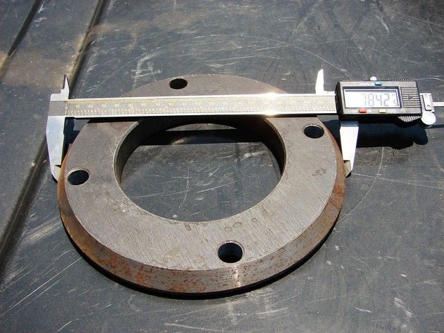

    here are the measurements of the plate that presses and is welded on. it bolts to the disc brake hat using grade 8 bolts. hub must be machined and this is then pressed and welded. its better to use 8 hole pattern.

    so here the measurementsverall diameter. 7.842, inside diameter 4.484, inside bolt holes5.596. lip on flange 0.372, inside flange width with lip 0.773, lip width 0.385, flange thickness 0.581, outside bolt holes 7.05.
    this flange is qual to the diameter of a chevy 12.5 disc brake hub.
