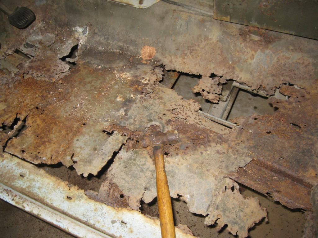

    I started to remove the rusty floors, I will try to save as much of the lower hat channels as possible, but may have to scrap over half of it
    Before
    Rear rocker support and cab mount. pretty bad, will need to see if I can salvage one from the other cab(which is just as bad as this one if not worse)
    removed,
    2 five foot sections of 14g metal bent up to match the existing hat channels,
    the rocker supports aren't that bad, mainly just the upper flanges, so I may be able to salvage most of those, except for that rear one, I'll have to see what happens when I take the sand blaster to it.
    if you notice, there was no bracing installed, the cab was already tweaked, so I am just going to try and do the best I can; obviously by not removing the cab, I should be able to get it pretty square and keep it true to the frame
    more to come later
