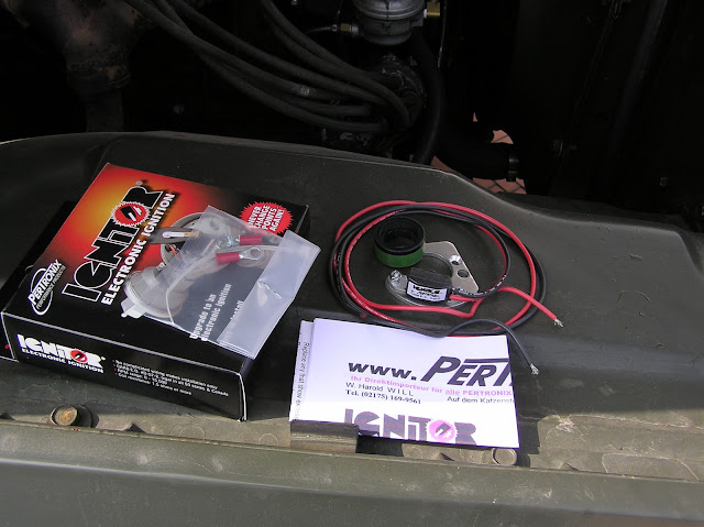

    Bought a Pertronix MV161 and began to upgrade:
    Ignitor without changes
    Default amendments
    Edit was limited to 5 Minutes, I missed that limit...
    Pertronix, only few items

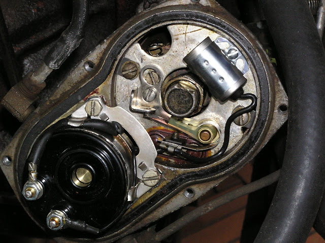

    condenser pulled
    more stuff pulled

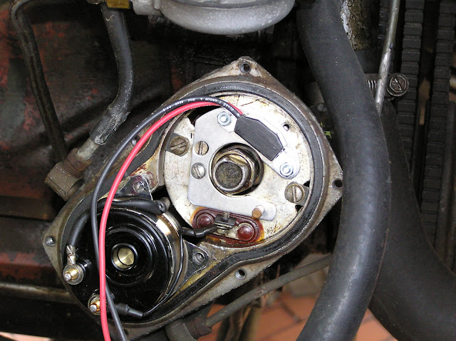

    Pertronix installed
    magnet sleeve: Please give a rough hint, have I have to turn it 180°?
    That's for the moment, I have to crimp a ring conncetor and then it should be done. Of course the rotor has to be installed again.
