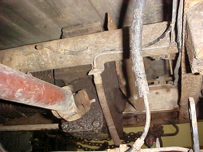

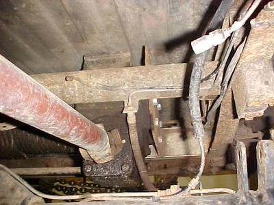

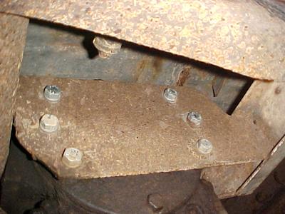

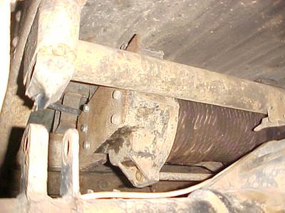

    Does anybody know how spicegear mounted his rear winch?
    Default tacomainoh :
    Re: Rear mount pto winch
    Post by tacomainoh on Aug 20, 2006, 11:12am
    I have some pics somewhere.... I'll try and dig them up.
    Barry put in a crossmember and some side plates w/the bolt holes on the frame I bought.... can't remember if that was for a 10k or 20k winch though. I think Tom did something similar.
    Whatever he did, you can bet that it was the simplest way. Tom's not one for elaborate fabrication.

    Post by barrman on Aug 21, 2006, 8:02am

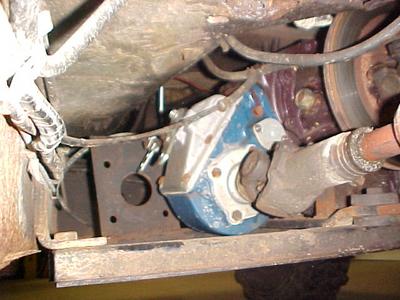

    Then he used the PTO port on the NP205 to power it.

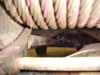

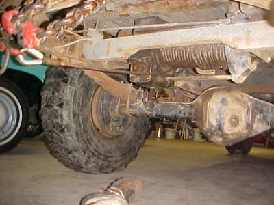

    I copied all of these from his Yahoo photos album...they were all in one folder about the rear winch....wish I had more details...
    In no particular order...

    Any ideas on how he did the controls?

    Can you run off the T-98 port with a 2 speed pto to the rear also?

    Post by jeepcj on Aug 24, 2006, 8:01am
    I can use the PTO off my Allison or the NP 205
