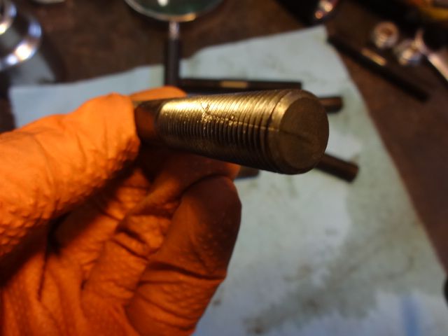

That was an interesting read. Good memories with those guys. Gimpy and Bump_r and I wonder what Doug is up to. From now on when I am putting a differential back in I will be paying attention to the torquing and if there is any doubt, replace the bolts. So I have an even better one for everybody. I was cleaning up my front axle parts and removing my high steer and cross over parts I found something I am really glad I spotted. A huge safety issue. The high steer kit comes with 1/2 x 20 studs to mount the arms on the top of the knuckle. Now keep in mind I have not torqued the nuts down on these studs. They were only installed to steer the truck and get it out of the shop to work on other vehicles last summer. No driving on them of any sort. 4 of the 8 studs were cracked all the way down the whole length of the studs. It looks like a heat treatment issue. I sent these three pictures to Ruff Stuff Specialties. I have looked for THREE SOLID HOURS NOW and cannot find 3 inch long Grade 8 1/2 x 20 studs with the same thread on both ends. Amazon ads up the ..... Well you know. I just can't find them. I think a 3 inch piece of grade 8 all thread will have to do. They tighten with lug nuts on top. It should work ok. But geez my luck with bolts and fasteners lately.
Have a look at these!
https://hosting.photobucket.com/imag...720&fit=bounds
Deep cracks too!

That is crazy...seriously!!!
Glad you caught it for sure!

So Ruff Stuff called me first thing this morning. They want back all the studs and are sending me all new ones. I can not speak highly enough of them. Back when I ordered my high steer kit, it showed up box crushed and torn open from UPS. Several expensive parts were missing. Ruff Stuff graciously and promptly replaced them. Now this time they were very concerned and they called ME. I have ordered a lot from them. And if I need more stuff I will do so again. I highly recommend them. I told Eric how I looked for three solid hours for a 1/2 x 20 high strength stud and no go. That the slew of page after page of amazon ads was disgusting. Bezos is a richard for allowing that to happen. To many counterfeits from amazon now. I avoid them like leprosy. lol I had better shut up since free speech does not exist any more. And I would hate to be fined by paypal for misinformation. So, How about that weather? It was minus 15 this morning. More painting weather...
