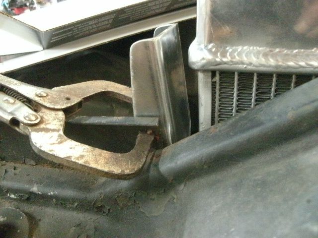

And for a quick update on the truck work. I finished all the radiator mounting using tailgate bumpers to keep it in place, and filled all the cut out sheet metal in the front grill support with new 18GA body metal, and also welded all the tiny little stress cracks. One more tiny section to replace on the back sheet metal radiator support and all the metal work for the very front is done. Some good progress so far.

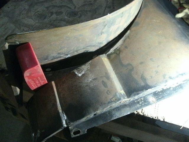

More progress. I work on it as much as I am able. Then plow snow. I want it to melt. I have been working on the front sheet metal. There is a lot wrong with it. The grill support has a large piece cut out right in front of the radiator. I found some 18 GA and made a patch and TIG welded it in. I did not duplicate the factory part. I put a fold in the edge by the radiator since there was plenty of room, and a fold will strengthen it. The factory panel has a cut back all the way across. Didn't see a need for it.

I had to go to town for a square nut. I had to replace part of the bottom of the radiator support down there on the passenger side. It looks good now.
I welded up all small cracks in the entire panel also.

So the radiator support was cut wider for the 502 that used to be in it. But the side channel was in need of a total rebuild. The bottom foot was to long, and the top was cut off. It was also not attached very well. I fixed all of it and filled holes and restored edges.

Got the bottom foot shortened and filled in missing metal. It now is a exact match to the drivers side.

I had to order some square metal tubing to repair the top of this part. I had no .109 thick metal and needed to wait for ever for it to show up. I cut it up and grafted it on matching the exact angle.

It looks good now.

I got it attached with several plug welds. That is done.
Next was the drivers side fender. It had the spot welds broken between the flare and fender metal from hard wheeling and it got welded back up out of position. The metal was thin and had holes everywhere. The fender flared out at an angle. Way misaligned... I cut all the welds, restored the edges, straightened the metal and filled very porous holes.
It was difficult to reach some of it. There is a lot of heat warping and bad edges. I will shrink the warping later when it is all repaired and on the rig. It is all to floppy now.

Rewelding after repositioning it where it should be.
