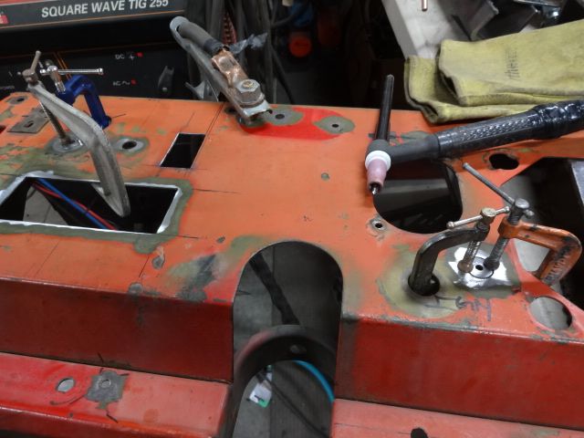

So moving on to the dash. I found the dash metal is a whopping 16 GA thick. I had hoped to punch some filler plugs with a hand punch. No go there and I ended up using some thick copper plate to back the holes. It absorbs heat preventing excess warping and makes for a flat sanitary back side weld. I was able to cut out the big hole for the 5 rockers and use that scrap for filling the bigger round holes. I used a blair hole cutter. Super clean cuts and not a hole saw by any means. The center pilot was great since I just wanted to reduce the hole size on some of them. I filled all the unwanted non OEM holes. And carefully cut the rocker holes to exact size called for.
https://hosting.photobucket.com/imag...720&fit=bounds

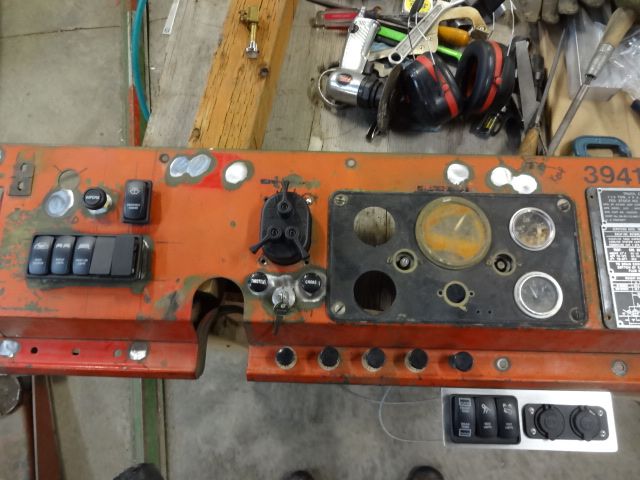

I got it all mocked up. I decided to put in a lower panel with two 12 volt lighter sockets.
Throttle and choke knobs.
The drivers side.
The heater push pull knob conversion. Plus now I am not using FSJ vent knobs. I ordered two more of the black knobs and will put the vents in the middle so a passenger can reach their own vent. Napa only ordered one knob when I requested two more. Someone was not listening and I have to go back for the last one still.
A ten thousand foot view. It will look sharp with my new Isspro gauges and a tan paint job.
