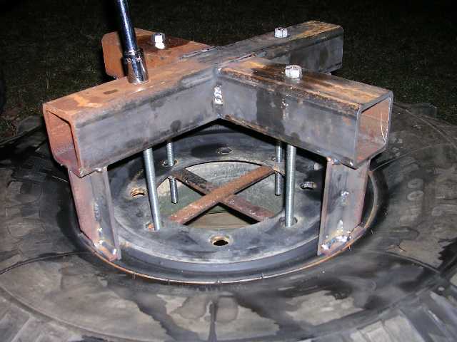

Before even thinking about doing this job, use a valve core tool to remove the valve core from each tire assembly. Wait until each tire is completely empty. Check it. Check it again. Air pressure behind the flange is what makes split rims fly apart. You don't want blood all over the inside of your shop, and it will be hard to do the rest of the tires one-armed. If you get lucky, you will bust your head open and not feel the pain. Leave out a couple of barf bags incase a new on the job paramedic hasn't seen a busted-wide open gourd with brains dripping out of it. Remember, if you hurt yourself doing this it's your own darn fault.
Here is the tool:
http://www.m715zone.com/jonmisc/lav1.jpg
The tool is pretty heavy, more than required, but I had a bunch of 3x3x1/4 cutoffs as scrap.
The first tire I did with a ratchet, to go slow and easy, after that used air wrench, and it went pretty fast. those 2 straps that cross on the bottom side of the wheel are just 1/4" flat, with a nut welded to either end so they won't rotate and you don't have to put a wrench on the bottom side.

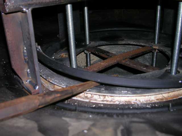

You have to mash the flange down about 1/4 to 3/8 inch, then the lock ring easily prys out:
http://www.m715zone.com/jonmisc/lav2.jpg

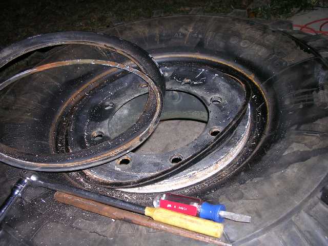

After lockring is off, lift off the flange. they are to the left in this picture. Then you remove the gasket, you can see it partially lifted here. Start it up with a screwdriver, then it just pulls off:
http://www.m715zone.com/jonmisc/lav3.jpg
Then you used a sledge to beat the rim out of the tire (it sticks on the runflat). I mixed some dish soap with water in a squirt bottle and wet it down before driving it apart.

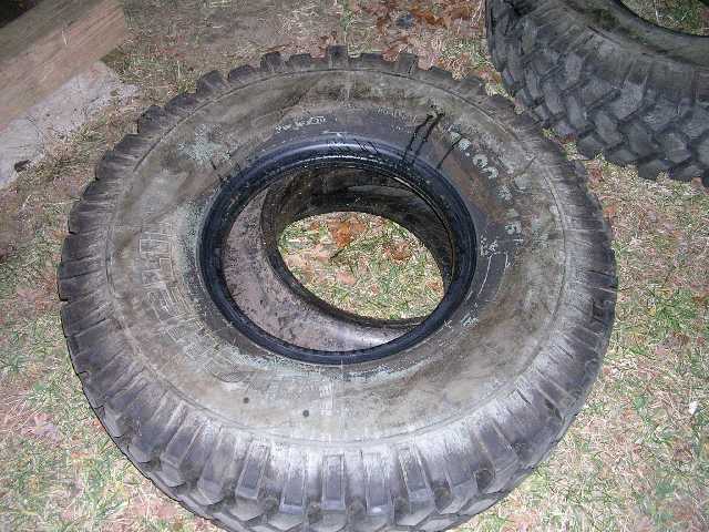

Here you see the runflat in the tire. It is about 40# of solid rubber.
http://www.m715zone.com/jonmisc/lav4.jpg
To remove the runflat, I used a ratchet strap to depress it, then sawzalled thru it, wrapped a strap around it, lifted on one cut end with the chainfall while I kept a foot on the tire, and it snaked out.
Somebody else posted a pic of using an engine hoist on an uncut runflat, with the XL up under the legs of the engine hoist. Looked to be faster and easier than the way I did it.

Once you get the jig made to compress the ring it goes pretty quick.
I used 3" 'C' channel (bolted in the middle), to form a cross. drilled 1/2" holes in the ends of the 'C', used 4" bolts to press down the lock ring. I tried 1 bolt in the center to pull down the cross to press the 'lock ring' down, but found out the 4 bolts through the 'lug' holes works best. It only has to go down about 1/4". MAKE SURE YOU REMOVE THE CENTER OF THE VALVE, TO LET ALL THE AIR OUT!!!!!!!!!!!!!!!!!!!! My,.02.

I used 2pc of 'C' channel with a 1/2" in the middle to hold them together, and 1/2" holes in the ends with 4" x 1/2" bolts to push the 'lock ring' down. Also drilled 4 1/2" holes to match the 'lug' holes in the rims to 'pull' it all down. JUST MAKE SURE THE AIR IS OUT FIRST! Cost about $25.00 for it all. I think the 'C' channel was 18" overall, and I bolted them 'back-to-back', so they made a cross (+).
