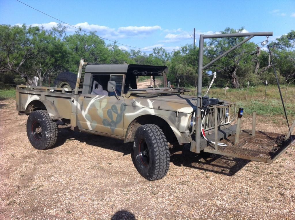

Here's my truck with Q78 Buckshot Mudders. I got 15 years from them. They finally dry rotted the side walls, tread is still 90%. My truck stays on a ranch in South Texas so all the driving is on dirt. 3 yrs ago I finally changed out the old split rims for 16" Marsh wheels and they are great. I will be selling these rims that are on the truck now.

They don't rub and ride sooo much better than the old bias rubber.
Nice truck. What's up front though? Almost looks like a mobile workout piece of equipment. Must be something farm related?

Deadhog, can you give any more details on the hardtop on your truck? That's a really simple, clean design. I've got a ratty old fiberglass roof, and I'm thinking about fabbing something like yours from steel.
Close. More likely it's for picking up the dead hogs to be loaded and/or quartered (see icechest).Quote:

This is what we call a Quail rack. You ride up front driving down miles of ranch roads looking for quail in the brush. Plus, the driver can watch you buddies with there guns. Hauling your animals back to camp! Or hunting buddies!

The inside view, I left the OEM frame and used automotive caulk between the roof and the pipes. I didn't want to damage or weld to the frames.
http://i1297.photobucket.com/albums/...ps91135620.jpg
The oustide is skip welded to the cab of the truck. The main roof is from drip channel across the top to the over side drip channel. I then welded the little vertical side plates in.
I installed a rearwindow with sliding glass (aka..beer window)from a Toyota truck.
Made it from 14 ga sheetmetal and used the windsheild frame for a template for the raduis. Add a little extra room around the windshield so that it will clear when you open/close it.
If you look at the front right corner you will see a squre tubing support that helps hold the roof. It's welded to a flatbar frame that goes across even with the top of the windshield frame for a seal. And the sq. tubing bolts to the dashboard. Hope this helps? I will look for more photo's. Sorry about the last photo its rotated wrong!:eek:
