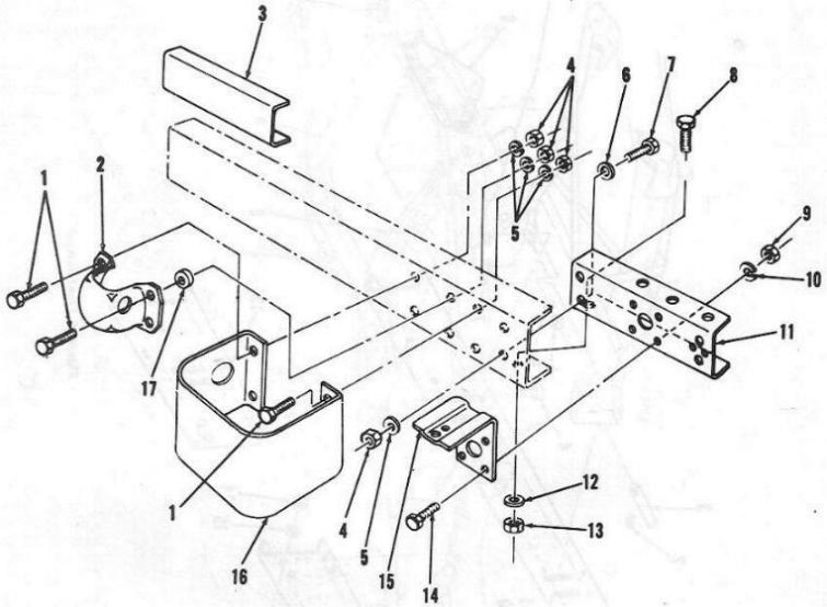

There is a spacer on the one side of the bumperette as seen in the illustration below, #17:
http://www.m715zone.com/jonmisc/fig91.jpg
I **think** it is pretty much the same as the ones on the rear axle under the lifting hubs to space them on the longer studs...will check on my truck tonight if no one else has by then...thickness dimension of the spacer would be nice to duplicate instead of a washer stack...
kwai :
Re: Extra Holes
Post by kwai on Sept 20, 2006, 11:45am
The spacers are the same as the ones on the axle. If anyone has some that they want to part with I need a few. Some of mine have gone awol.

compexp :
Re: Extra Holes
Post by compexp on Sept 20, 2006, 7:45pm
I just cut a piece of 1/4" flat stock and drilled holes in it for the spacer.
barrman :
Re: Extra Holes
Post by barrman on Sept 21, 2006, 8:13am
That is exactly what I was thinking of Rich.
