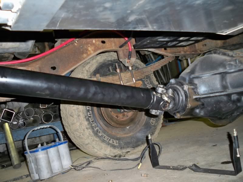

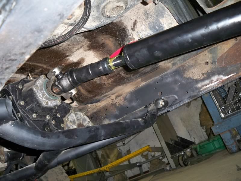

installed the rear driveline today and got all the lights to work. i have a few more wires to figure out and decided what i am using and what i am not, then loom it all and be done with that nightmare. should at least get to move it under its own power tomorrow

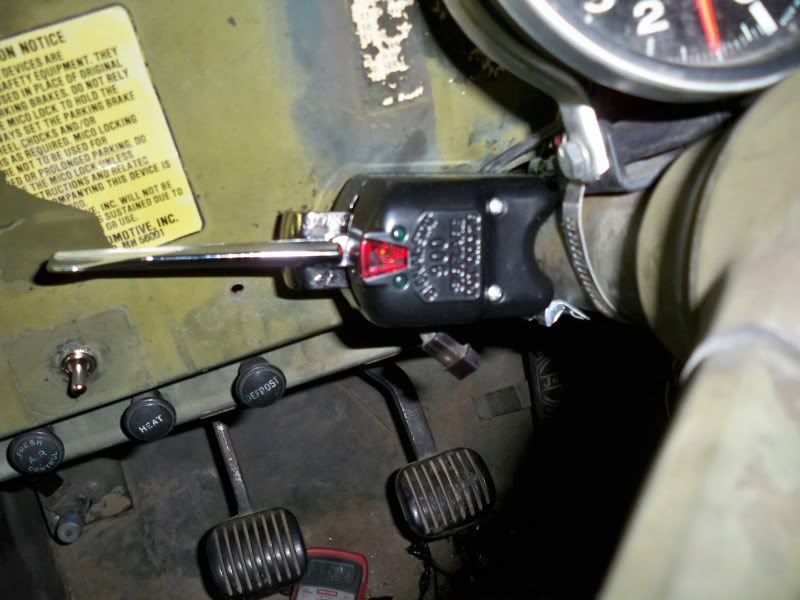

generic turn lever i got at napa

The Signal Stat 900 is the exact switch I used in my M715. With some OD it looks almost stock. It wired in perfectly with my harness that was a Painless knock-off. The only thing I had to do was to add a second flasher unit for the Hazard feature. The wiring harness kit only came with a single flasher for turn signals. No big deal, only three extra wires to run. They also make another switch that has the hi/lo beam incorporated into it as well. I may change over at some point. My floor dimmer switch always seems to get packed with mud after a wheeling trip.
If I have any complaint, its that they aren't self cancelling. Kinda nice for those 40 MPH jaunts down the highway with a mile of cars behind me and the left blinker on.:D

this one wired in perfectly. i had two flashers in my harness and all i had to do was plug and play. i have a couple things to figure out today with the guages and i think i will go ahead and wire in the 4wd switch too. headed out soon to do that. i will report back later.
