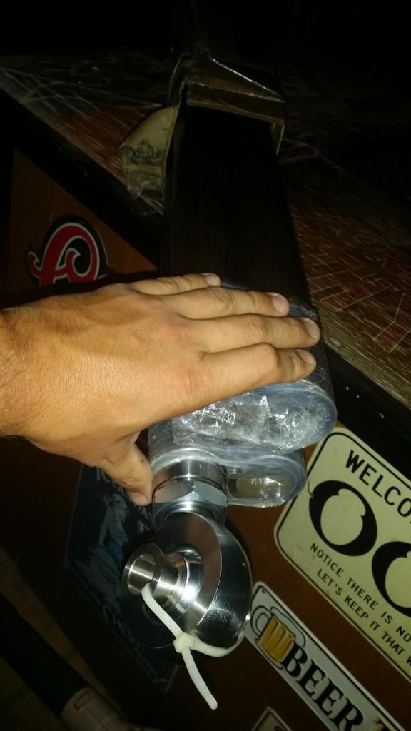

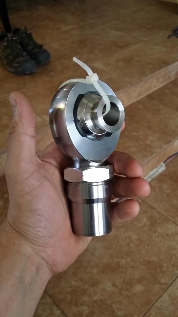

Here are the 1.25 inch Hiems from Ruffstuff with SS misalignment spacers, jam nuts, and tube adapters. Got 8 of these total half right/left hand thread. Last week Ruff Stuff had a 20% discount going on so I purchased all of my 3/4" grade 8 hardware and material for the rear 4 link, 2 inch .25 wall DOM.

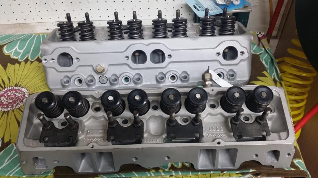

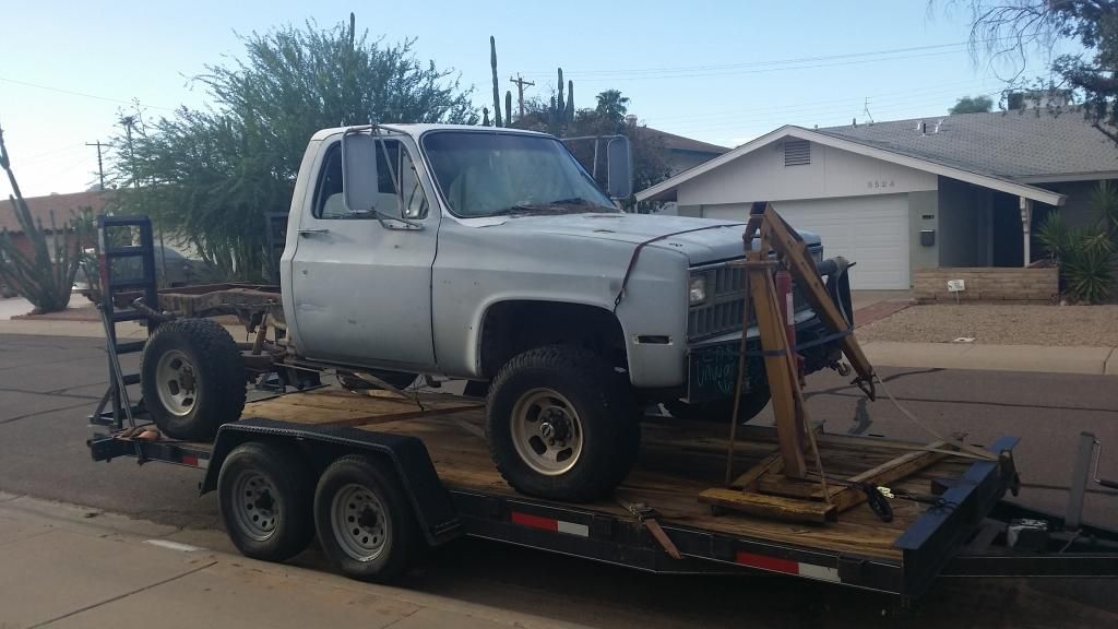

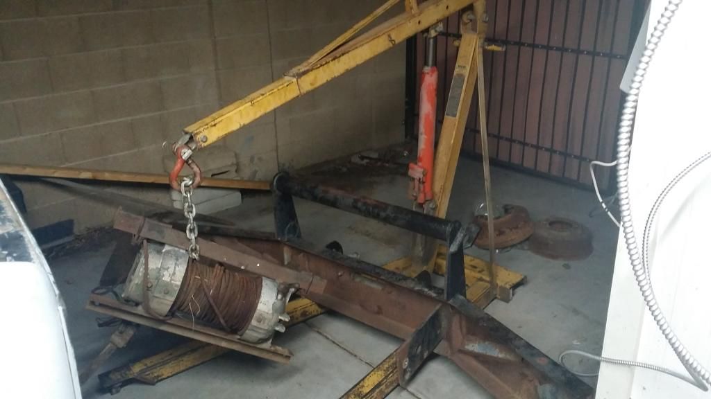

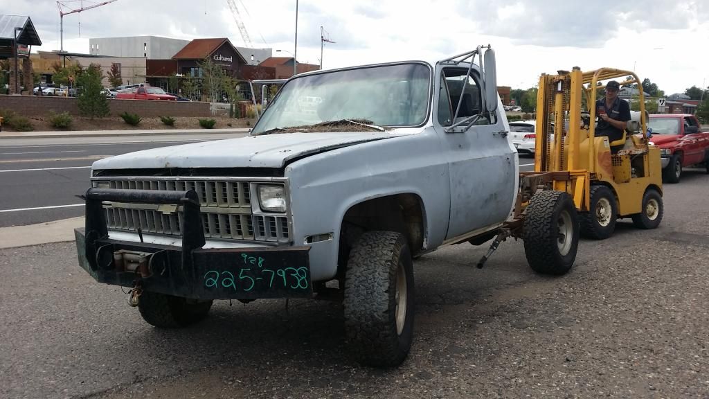

Kind of a side bar, but I got this Chevy Truck for $400 bucks I’m parting out. Its gotta PTO Braden LU2 winch on the front I think I’m gonna keep and eventually mount to this truck. Also found the front driveshaft is the exact same size at my green M715 so I gotta spare now. After cleaning up some of the grime I found out the 14 bolt rear has a locker and the 350 as Edelbrock Performer Aluminum Heads. The p/n on the heads price them out new north of $700 a piece!!! I’m gonna tear the engine down in a few weeks to see what other goodies it might have plus to inspect it since there wasn’t a carb on the intake but these heads could be finding their way on to this truck as well.

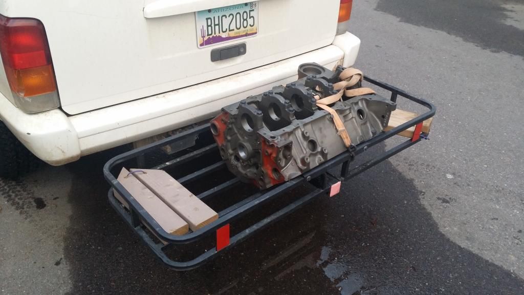

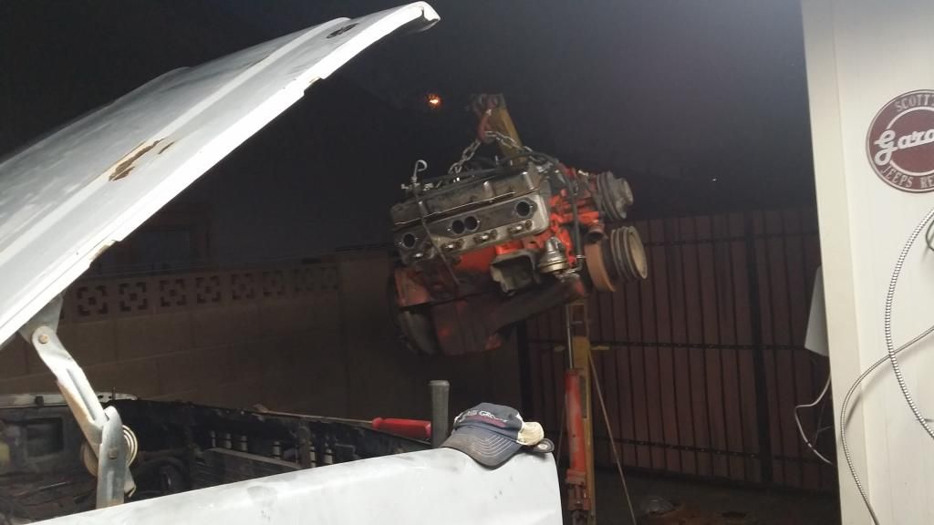

I pulled that motor all apart and it had performance pistons, lifters, rods, and a mild cam on top of those performer heads. One of the cylinders had water in it though. I decided it would be worth it to build up this engine and eventually put it into this jeep. I had to have one cylinder sleeved, valve job on the heads, and the other standard machine work for the block and crank. Here's me picking it up the hard way since my other trucks had trailers hooked up to them.
