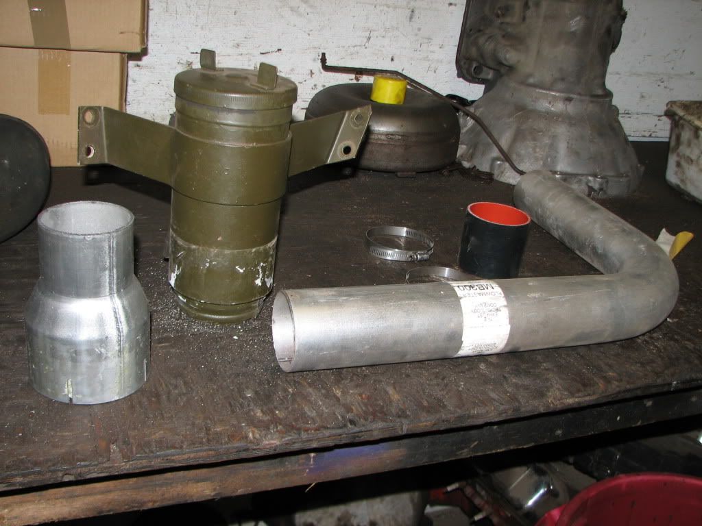

Ordering a custom radiator from Griffin. I was going to try to retain my stock radiator, but I was running into complications in making adapters for the size difference in tubing for hoses. 1.5" vs 1.75" and 2.25"
Which Radiator did you buy? My stock rad is on its way out and im looking into options to replace it. I eventually want to convert to a Cummins and want to make sure I buy a radiator that will cool it. Beautiful truck by the way!!!!
Yeah if I blow a radiator hose i am bummin'. I had to make a 90 with exhaust tubing adapters that make that big jump on the lower hose. I would like to know how much that radiator is and how it cools when its hot or under a load.
The 2.25" inlet is the tough part. When you don't have a/c, the tensioner is there :-( And it is tight. If possible, I would cut the radiator support and fit a wider radiator, but mine is already painted. I am having them make an angled inlet that is 2.25". I hope it clears. I'll let you know a price once I get billed :-(
