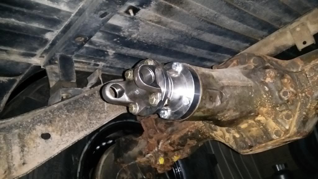

This week my flange adapters came which adapt the flange on the pinion adapter to a 1410 series end. I went to the driveline shop today to get some pricing on what my options are. Ideally I want to run 1410 series u-joints everywhere but everything comes down to price. I have a 1350 series driveshaft that could be modified but it might be smarter to turn that into a spare for my other truck.
My cheapest option would be to get some of those special conversion U-joints that have two different sizes on them but they cost about twice that of a regular U-joint and I would still need to pay to have the shaft cut down to the right size. I’m not going to get a driveshaft made until the suspension is finished so my dimensions are the most accurate. Maybe by then it will just make sense to pay and do this right the first time.

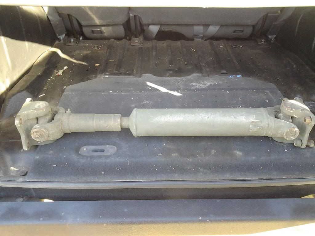

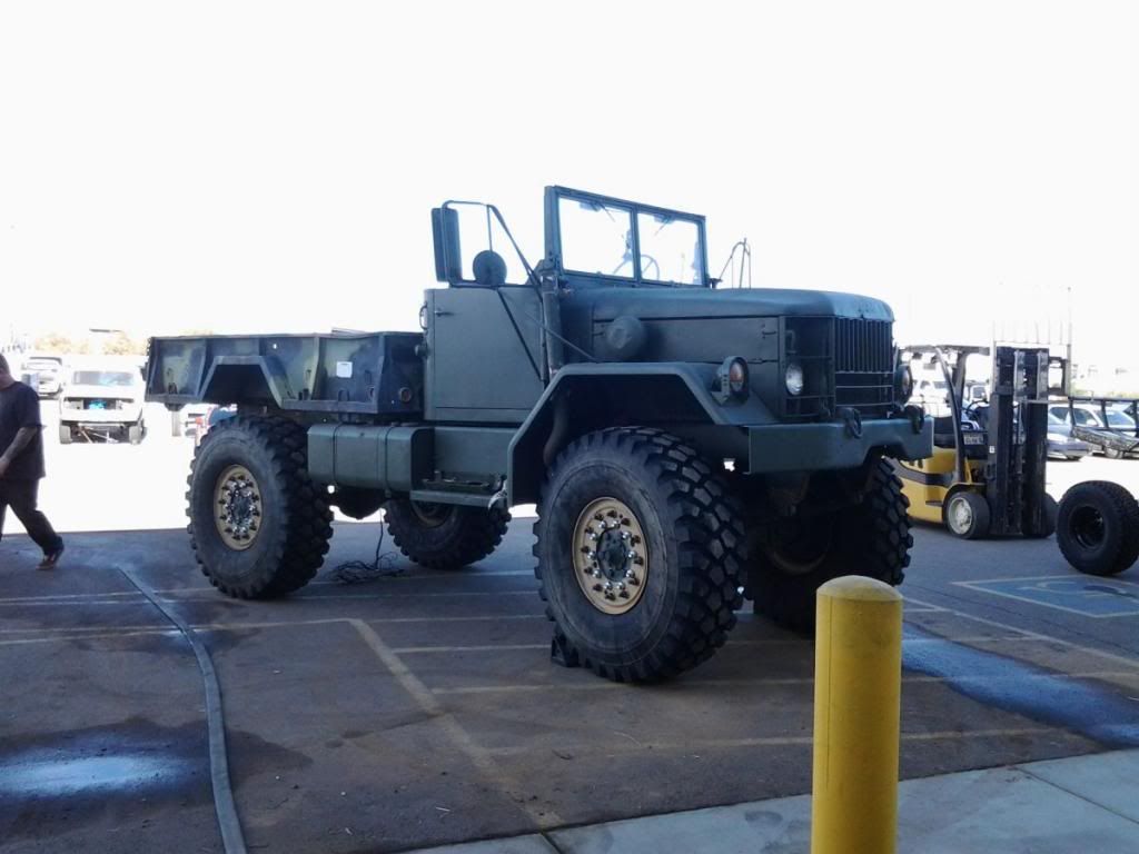

Thanks for the info on the deuce and a half driveshafts I didn’t know they were that 1410 size. A guy I work with is in the middle of a bobbed deuce project and I asked him where to get some driveshafts. He gave me his intermediate shaft for free but its only 30 inches so I’ll only have to pay to re-tube/lengthen it. Here’s a picture of the driveshaft and one of guys M35 he’s building.

I had to have one shaft lengthened and one made shorter. I got mine from a member here at a great price.
