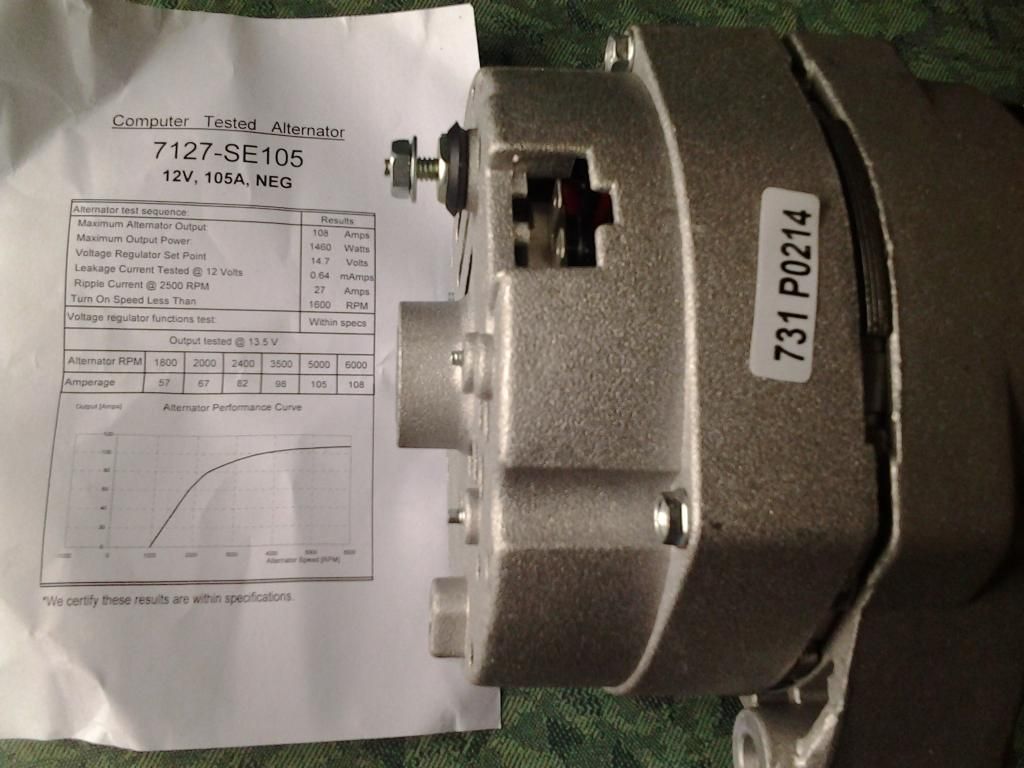

Got 105 amp alt to replace the 63 amp, hoping to get more power. Otherwise it's been running well, just need more charge for the 3 batteries.
http://i1109.photobucket.com/albums/...813_150545.jpg
