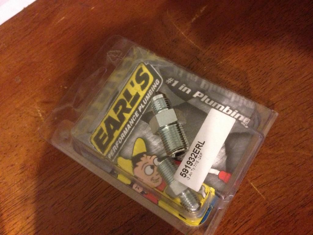

I ordered the parts to replace the front brake hoses for both my M715 and my M725 with stock wheel cylinders. Listed is the total order to do two vehicles.
(2) AAF-ALL50100 -3AN to 3/8-24 female inverted flare (pair)
(2) EAR-591932ERL -3AN to 7/16-24 male inverted flare (pair)

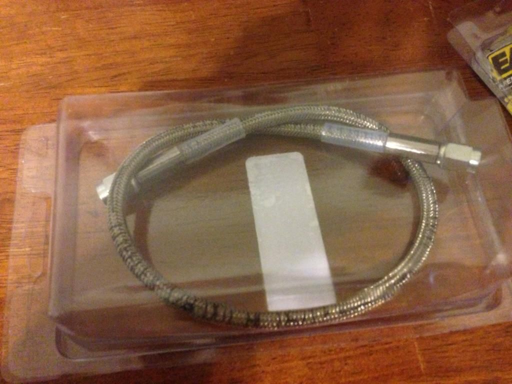

(4) Sum-220306 -3AN 20" long braided brake line (each)

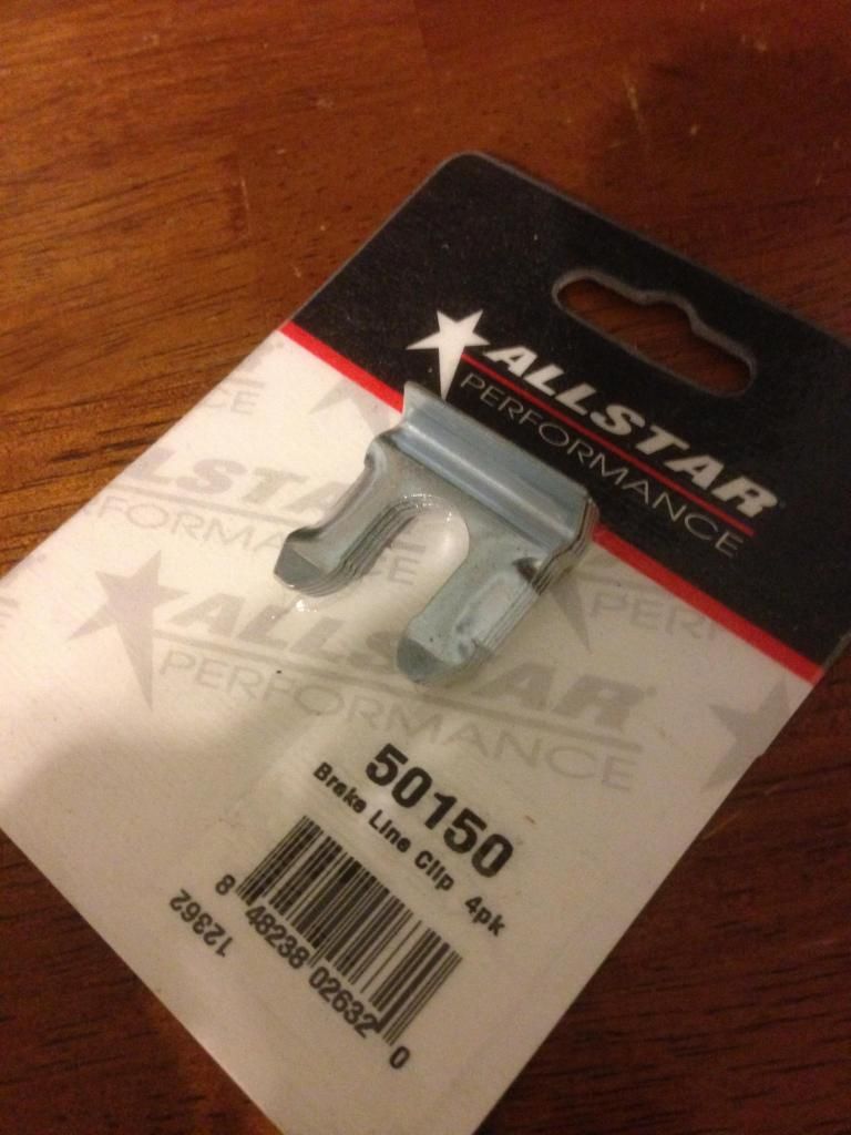

(1) AAF-ALL50150 brake line retaining clips (pk 4)
