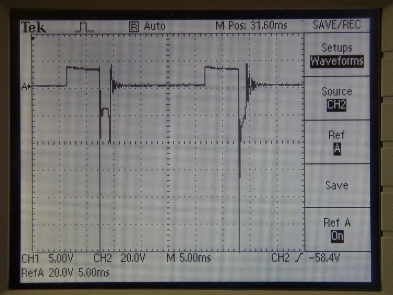

As an example, here's a 'scope display from when I showed someone what a misfire looks like:
http://www.bushytails.net/~furrywolf/spark01-small.jpg
On the first one, there's a sharp spike when the points open, a level area during the spark itself, a small peak once the spark ends, then lots of quick oscillations. (while not relevant to this discussion, the second one shows a no-spark misfire - the sharp peak happens, but rather than showing a level area as it sparks, it just decays without ever sparking)
During these oscillations (the squiggles to the right of the spark), the condensor is charged and discharged thousands of times a second with alternating polarity, slowly decaying due to resistance in the circuit.
