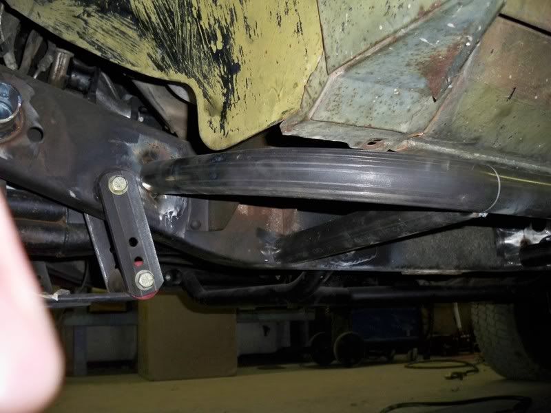

here are my hangers
http://i94.photobucket.com/albums/l8...15/m715249.jpg
http://i94.photobucket.com/albums/l8...15/m715250.jpg
http://i94.photobucket.com/albums/l8...15/m715251.jpg
http://i94.photobucket.com/albums/l8...15/m715252.jpg
be warned when you go to cut the hole for the bushing tube, this will likely plague your attempt.
http://i94.photobucket.com/albums/l8...15/m715209.jpg
shackle location and angle.
http://i94.photobucket.com/albums/l8...15/m715300.jpg
these are just normal lenght chevy front springs, so yours will be different no doubt with the 52s.
also when i set mine up the first time i did it with the stock wheelbase. i found after tacking everything and looking at it that moving the front axle 1 inch forward made it all look better and made the tires fill out the wheel well better

Thanks for the hanger pictures. Ive been eyeballing that for a while, what to do, etc.

Pretty welds on those hangers!
Those BTF brake brackets on the 14??

those front hangers are sweet !!
did you make them from scratch, is it a kit . whats the scoop?
