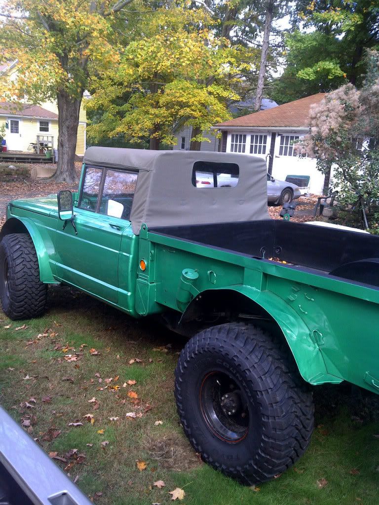

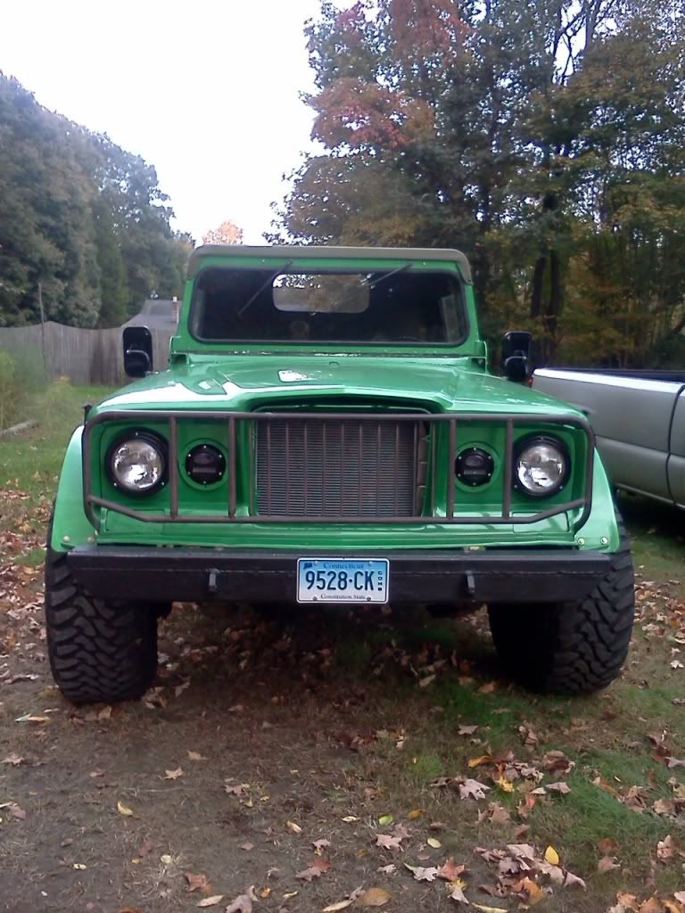

My truck is at the upholsterer's getting a new top made with #8 Army Duck. I couldn't use a reproduction top with my modified bows. I also ordered a little electric windshield defroster for the mean time while I don't have a heater.
The top is finished on my truck. I picked it up this past Monday. After the rain we have had for the past few days, my wipers quit working. I have to see if it was the switch or the motor.

Top looks good. Think there will be any problem with water pooling on it since it is so flat?
On another note, your trees are not as red and orange as ours are 450 miles South of you. Looks like they will peak shortly here.
The top looks BA!!!! Almost like the truck is back in the service with a fresh flat top hair cut!!
