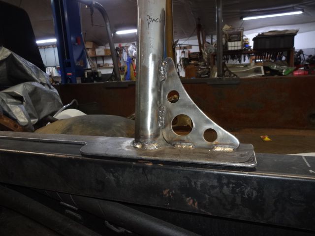

I spent 5 days cleaning up my shop. It needs more. But I wanted to do something to the truck. Now somewhere I had posted about the Chevy K30 master cylinder and which port was the front. Online just about everywhere states the smaller port closest to the booster or in this case the hydroboost was to the front and is considered the primary port. . It seems that I found it was opposite for the K30. But I can't find the thread. And I can't remember... Thank you covid... Today I plumbed it out with a new line doing what all the reading said online. I can change it if I need to. I ran out of 3/16 brake line so time to go get more so I can do the back circuit. I did plumb the clutch master cylinder earlier to down below the steering column to a brake line tab with the 5/8 hole. It transitions to a rubber line and connects to the clutch slave cylinder. After line clamps get installed that is done. The roof top tent rack is done except drilling through the rack base to the bed. I got the gussets welded in. Then made clamps out of SS exhaust clamps with a piece of exhaust tubing welded in to hold the tent down on the 1 3/4 dia rack. I will put rubber on the clamps after it is painted. So no serious scratching from the tent clamps. Nice to be back on the truck today.
The gussets.
