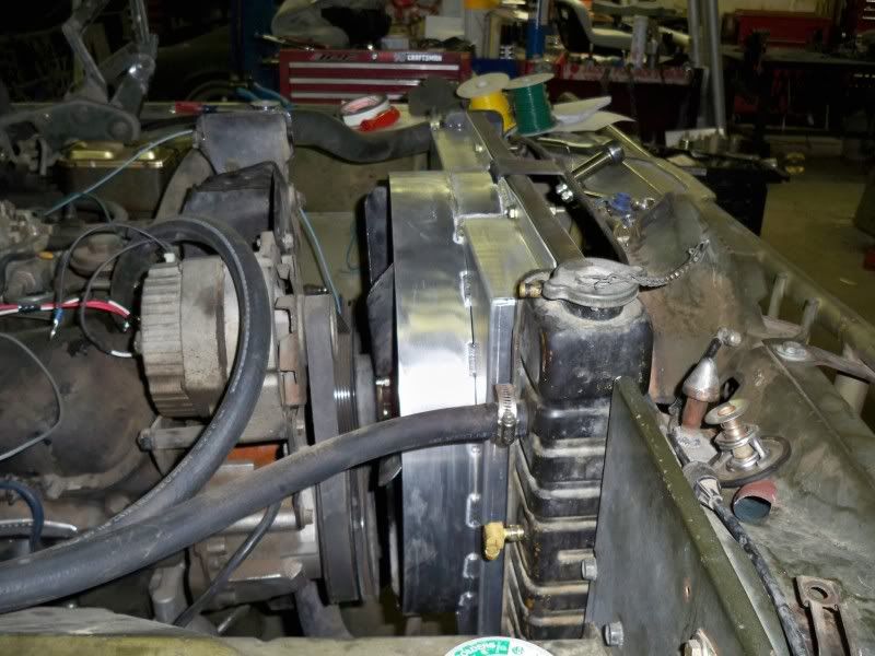

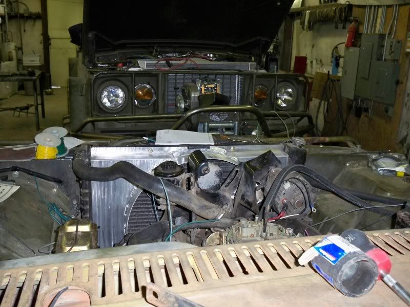

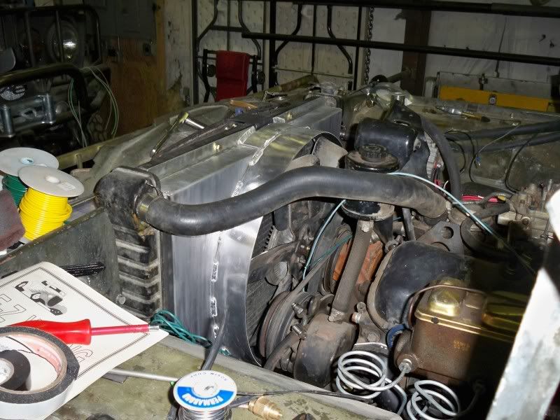

today i got the front lights all finished up and started working on the engine harness. although the quality of components seems as good as painless, the directions are very much less with the EZ wiring harness. thank goodness painless has a PDF file online for download. i wired in a maxifuse for the the main harness power as opposed to the provided "fusable link" provided.
also got the HEI and alternator circuits terminated.
