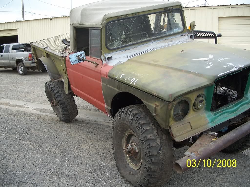

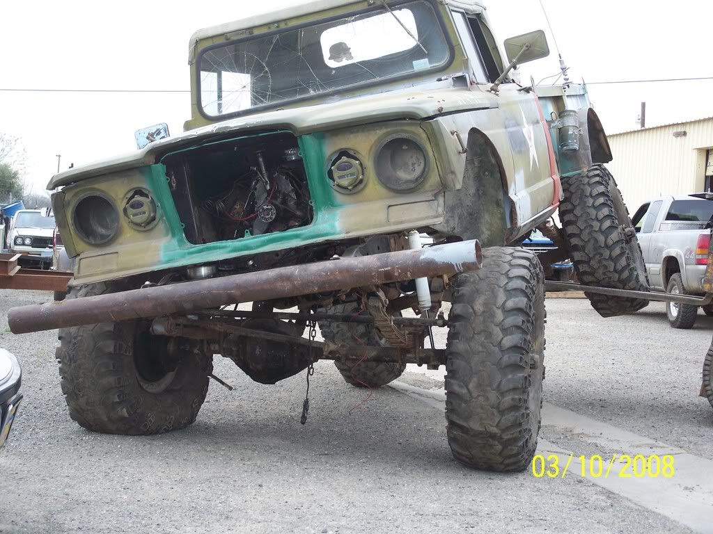

hey, im running into a problem.... now im getting rid of the body lift, i think im going to use about a 1 or 2 inch.... but right now i am having a problem with the pannels lining up. my hood needs to move over about 1 inch to the driver side, the cab needs to move twords the passenger side, the grill...god dosent even know what to do with the grill... has anyone else had this problem, the hood and cab look great, but it needs to move, so its like idk ha...
this narrows it all down I AM GOING CRAZY, this truck has me beat. i need to get a camera to show you guys this...

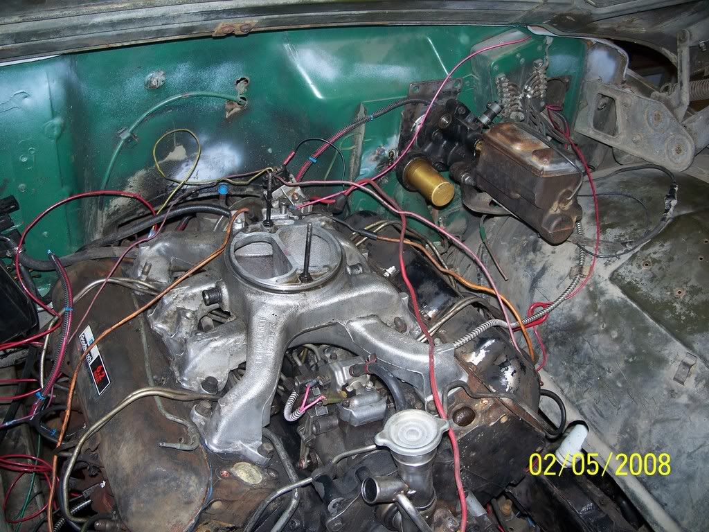

spagetti any one, wiring sucks, but it will be clean, this is just the beginning
