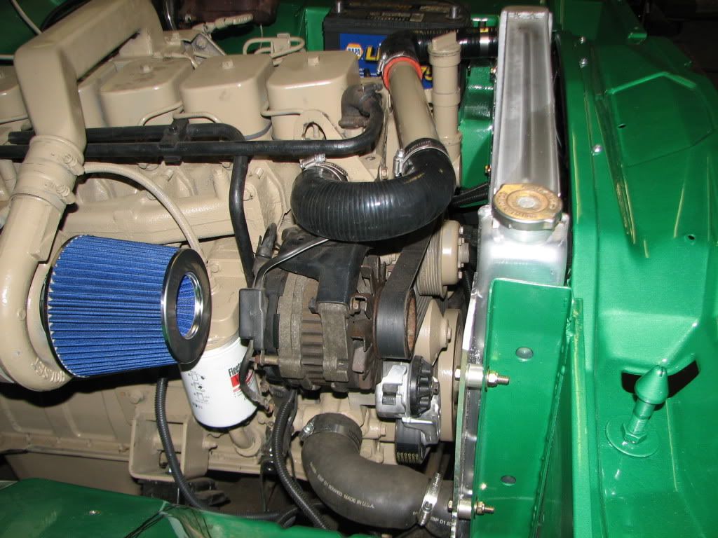

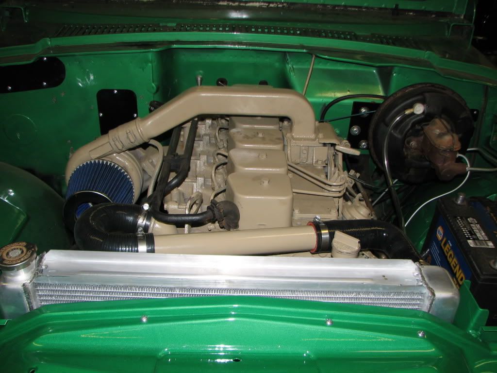

all looks good, but have you considered a 180* mandrel bent pipe to replace that rad hose. Jegs ect. sells them.

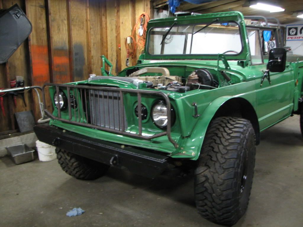

I had a pin hole in my radiator. That is now fixed and reinstalled. I finished the under hood wiring and front lights. I mounted the brushguard. Saturday I will finish the bumper I started last summer. Truck should be on the road within a month.
Putting in a heater?
I had one when i had the gas motor. I will eventually put a universal jeep one under the dash. I still have the defroster ducts in place and the fan switch wired.
Sounds good. I was wondering pretty sure it gets cold up there where u r. Lol
Looks nice. Lots of good work.
I finished welding my front bumper, painted it and mounted it today. I accidentally dropped it and put two holes in my concrete floor. It is 3/16 wall 2x4 with a 2x2 weld atop it to make a 2x6" bumper. I used 1/4x3" strap to make the mounts. It is heavy
