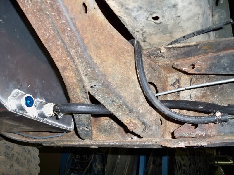

did a little tinkering today. plumbed in the feed and return line for the fuel tank. i had bought a slew of rubber hose for the job but decided to make the majority of the line out of steel instead. so i had to cruise back to napa and trade my rubber for steel line.
anyhow, i still have to plumb the tank vent up to the air cleaner. i also need to get some more line clamps for the smaller vent and return line. i think i will use the same thing i did for the brake line only get the double line version.

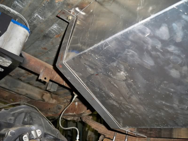

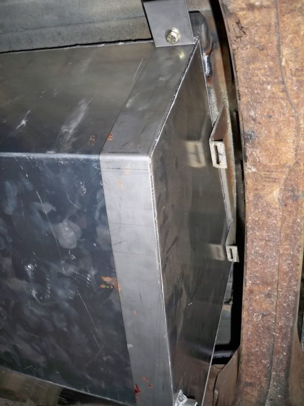

got the tank installed with the stainless straps i made. they are 308 14 guage. had to do some patching to get into an area of the filler neck that was still viable after 40 years.

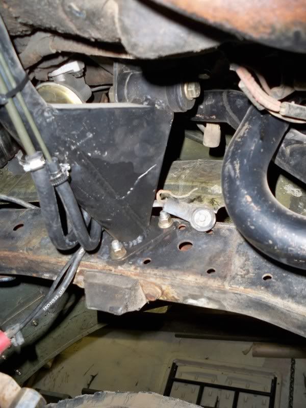

here is the pickup line and the return is the rubber peice that comes in from the top of the crossmember. after having built the tank i have found a few things i think i would do differently if i was to remake it.

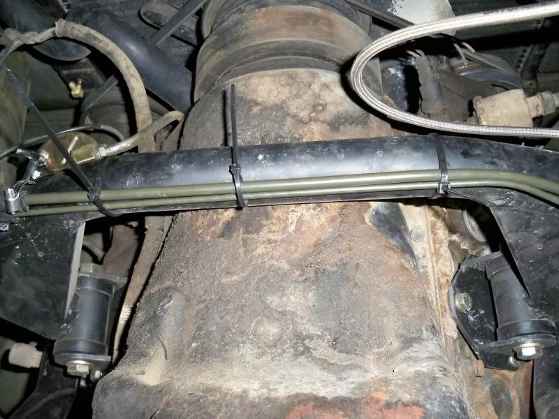

steel lines for the fuel.
http://i94.photobucket.com/albums/l8...15/m715355.jpg
for now they are zip tied to the crossmember. i will have to figure out a better way to hard mount them on the crossmember. or they may end up permenantly mounted with zip ties. the return is zip tied to the feed line, since it is mounted with line clamps on the frame rail. i need to order some more cool guy billet line clamps for the return and the vent line that will eventually be run with it.

the pump ends of the line with the short rubber lines to the pump
