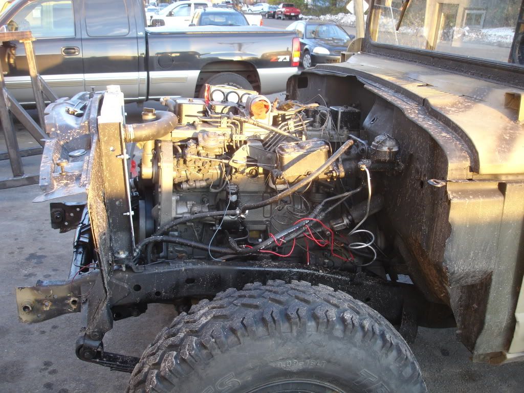

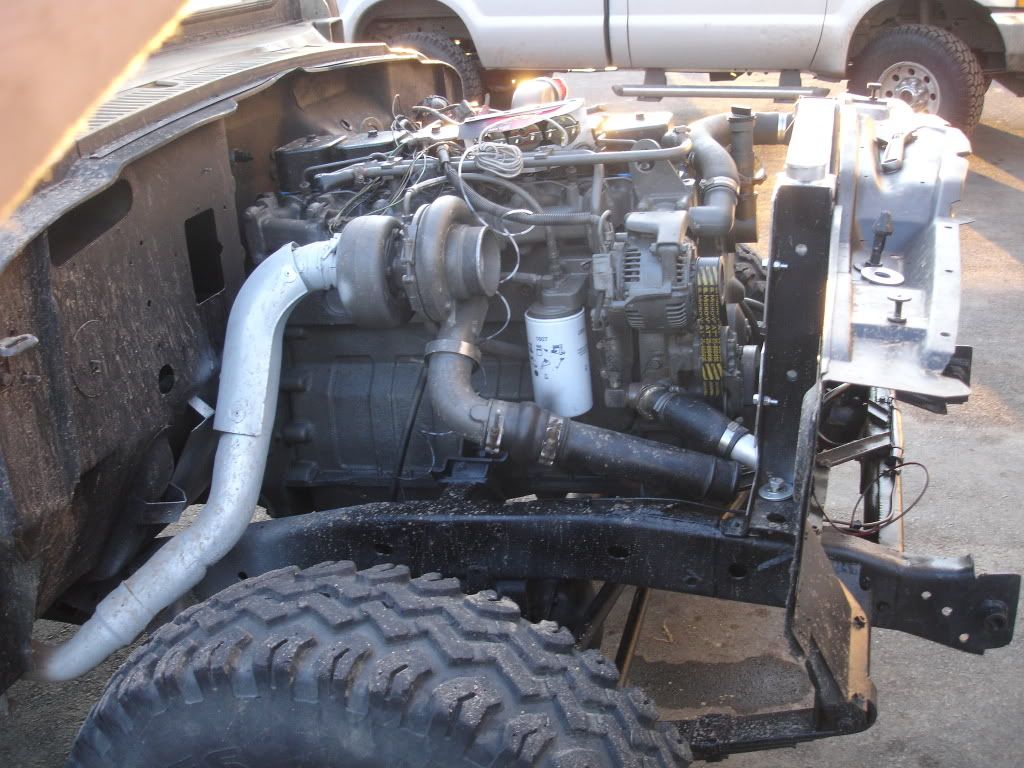

Here is the radiator we used.
http://www.summitracing.com/parts/SUM-380328/
Some photos:
http://i305.photobucket.com/albums/n...9/DSC05215.jpg
http://i305.photobucket.com/albums/n...9/DSC05214.jpg
http://i305.photobucket.com/albums/n...9/DSC05213.jpg
http://i305.photobucket.com/albums/n...9/DSC05216.jpg

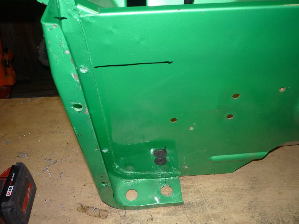

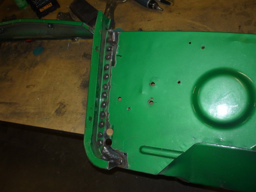

Mikel would be proud of me lol. I took his advice on my radiator support.
http://i870.photobucket.com/albums/a...5/P1010141.jpg
http://i870.photobucket.com/albums/a...5/P1010139.jpg
http://i870.photobucket.com/albums/a...5/P1010136.jpg

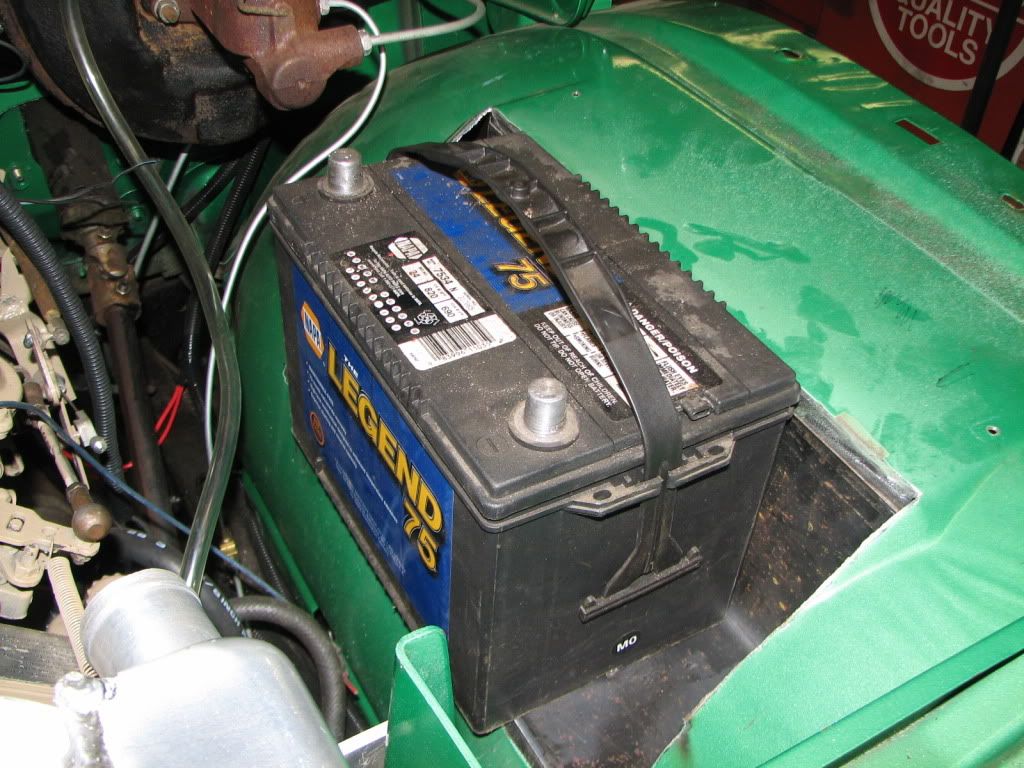

I should have my summit radiator soon and then the fun begins... Today I installed the new u-joints in the rear driveshaft and installed it. Just so everyone knows not all of the u-joints on an M715 are 1310, the rear axle u-joint is a 1330. I had to get a conversion joint to go from the Dodge 7260 to Spicer 1330. I also installed the exhaust hanger. I have decided to move the battery to the driver side and I will notch the inner fender to do so. I also ordered an air filter for my motor.

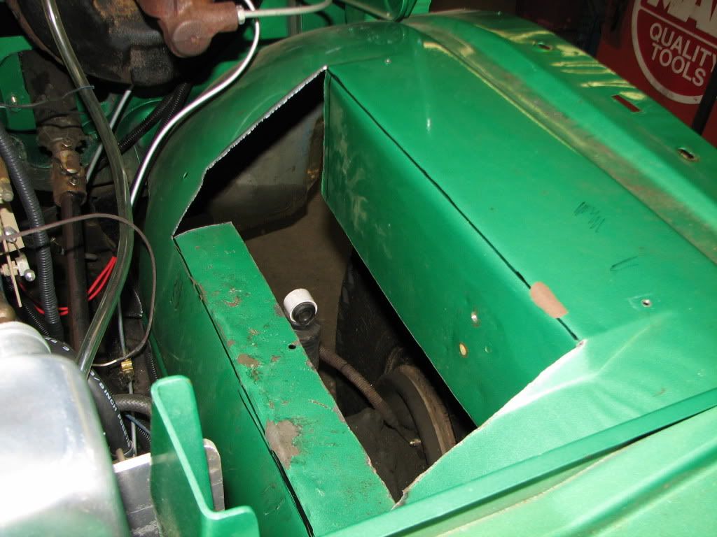

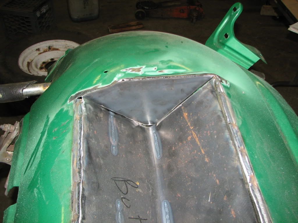

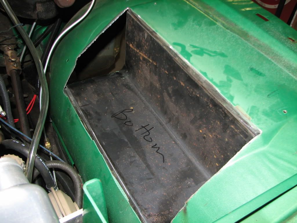

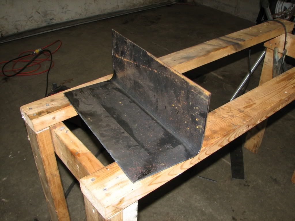

I relocated the battery to the driver inner fender. I had to make a pocket. The radiator support and inner fender are off to paint.
http://i870.photobucket.com/albums/a...M715/001-1.jpg
http://i870.photobucket.com/albums/a...b/M715/002.jpg
http://i870.photobucket.com/albums/a...b/M715/003.jpg
http://i870.photobucket.com/albums/a...b/M715/004.jpg
http://i870.photobucket.com/albums/a...b/M715/009.jpg
