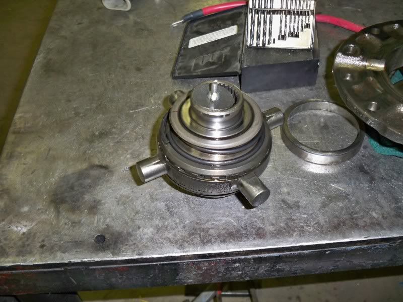

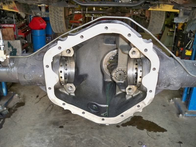

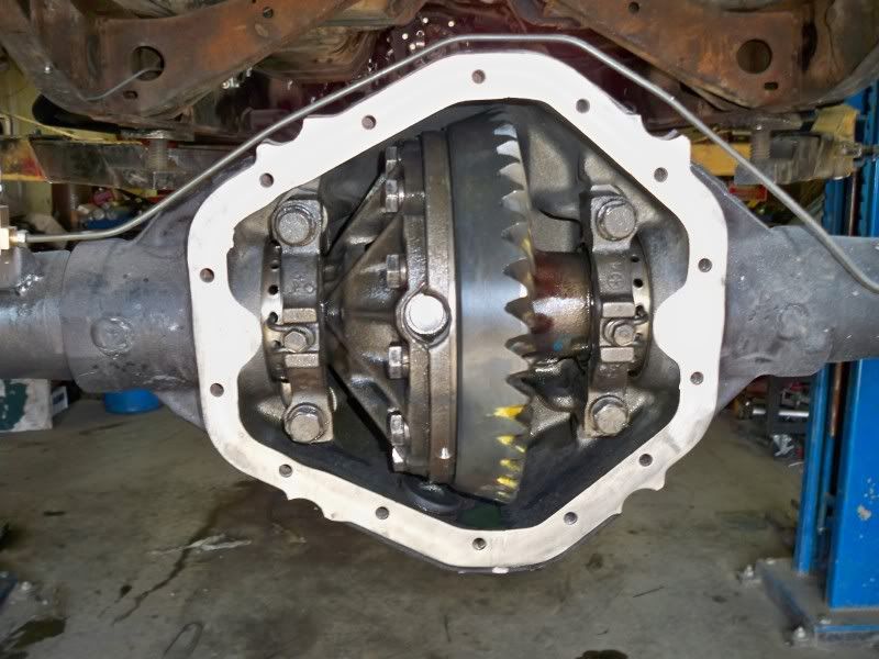

detroit is in the rear. i will post up some pics later
http://i94.photobucket.com/albums/l8...15/m715316.jpg
http://i94.photobucket.com/albums/l8...15/m715317.jpg
http://i94.photobucket.com/albums/l8...15/m715318.jpg
http://i94.photobucket.com/albums/l8...15/m715319.jpg

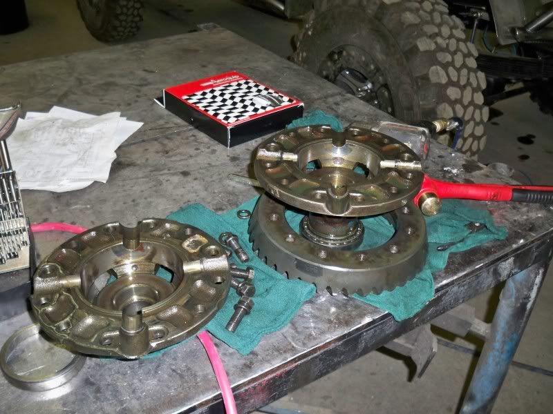

i scored a detroit for the rear for free, so i installed that sucker

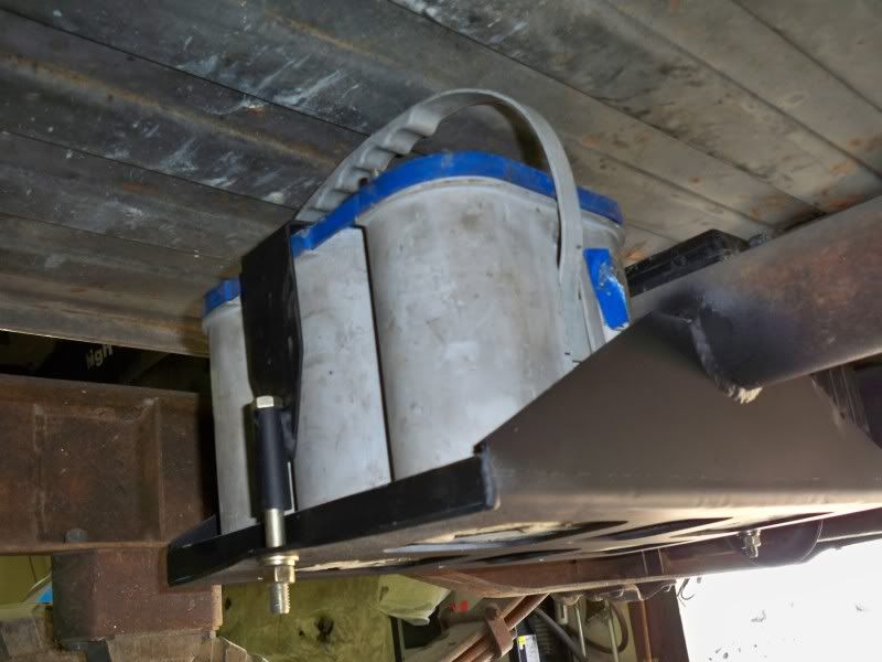

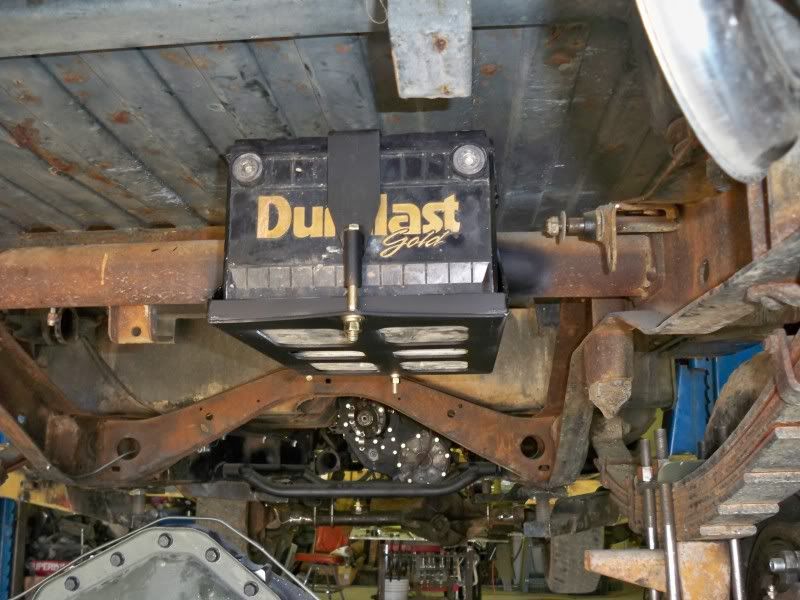

also finished up the battery hold down
http://i94.photobucket.com/albums/l8...15/m715323.jpg
http://i94.photobucket.com/albums/l8...15/m715326.jpg
and sprayed some camo green krylon on the steering links. i think i would have done them in black, but i ran out painting the battery hold down.

The battery bra. :D
I do like the placement of the batteries. Never thought of stashing them underneath like that. Good idea!

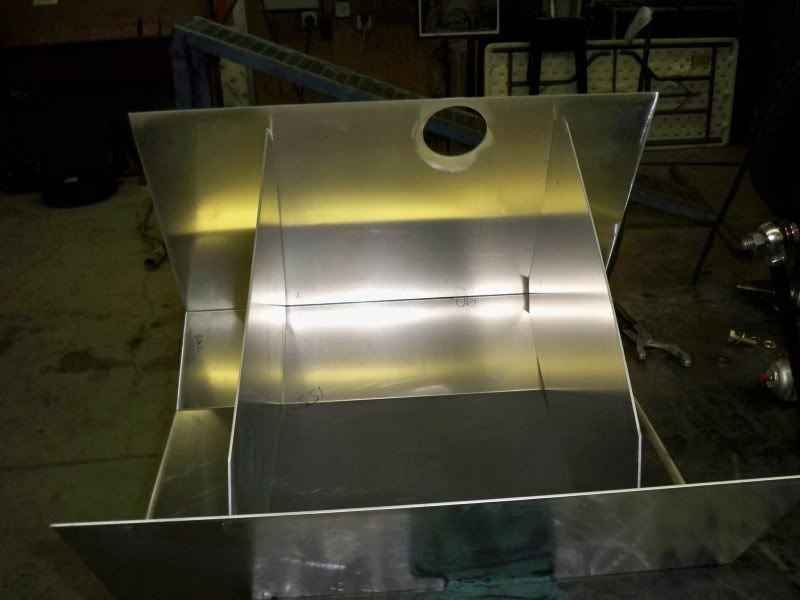

going to the shop for some gas tank building. i promise to remember the camera this time

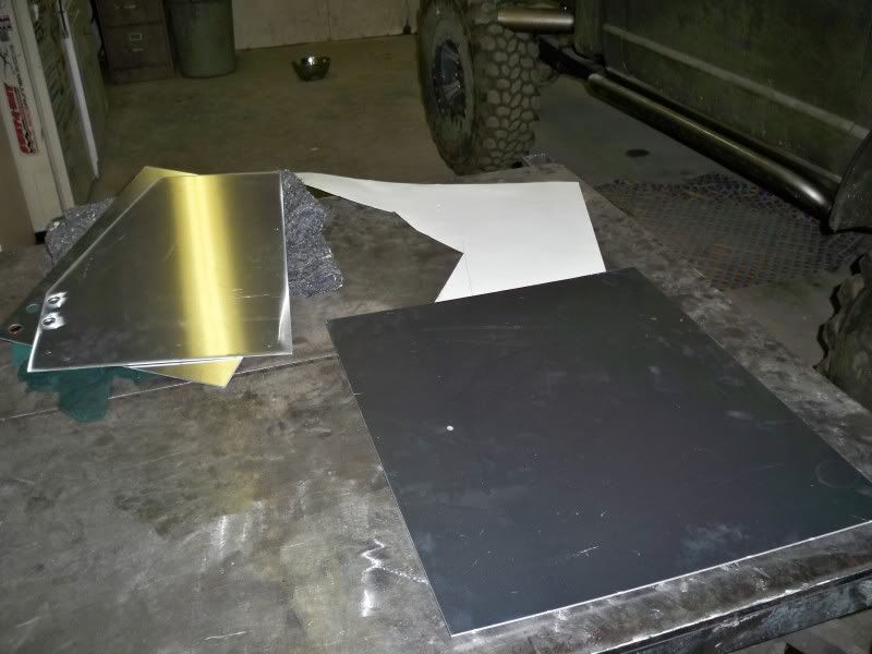

the gas tank
the parts
http://i94.photobucket.com/albums/l8...15/m715338.jpg

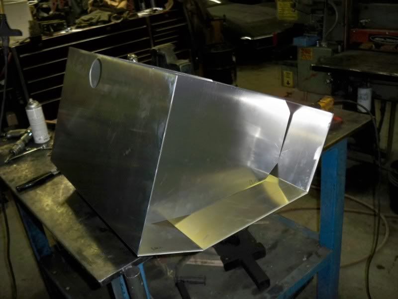

baffles in place
http://i94.photobucket.com/albums/l8...15/m715336.jpg

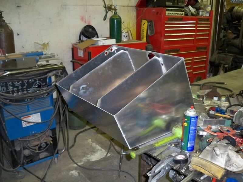

http://i94.photobucket.com/albums/l8...15/m715339.jpg
sides tacked in
http://i94.photobucket.com/albums/l8...15/m715343.jpg

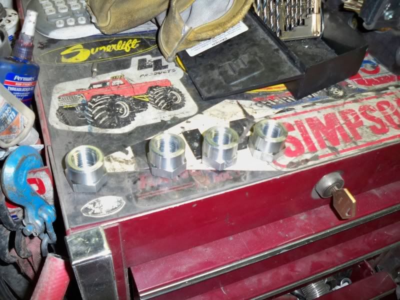

the weld in NPT bungs as an afterthough i think i would have rather used male AN weld bungs, or strait thread bungs and o-ring fittings. maybe next time.
http://i94.photobucket.com/albums/l8...15/m715345.jpg

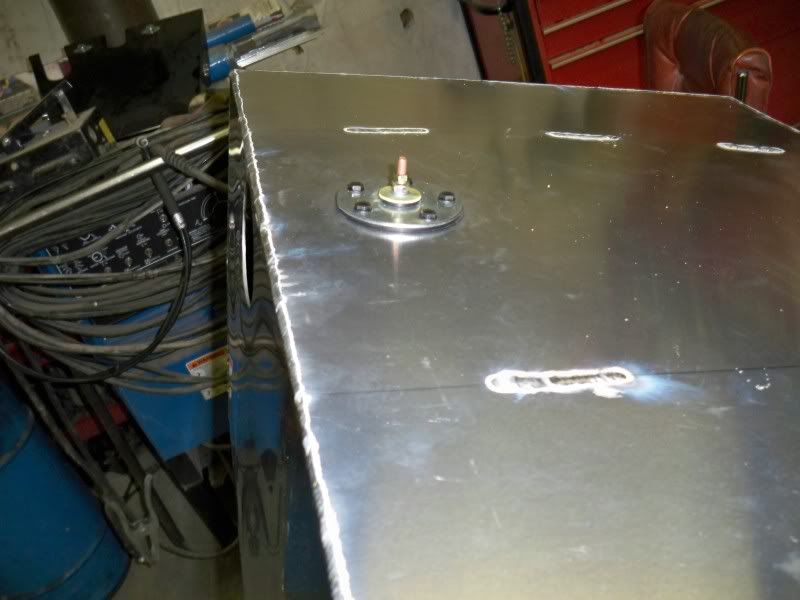

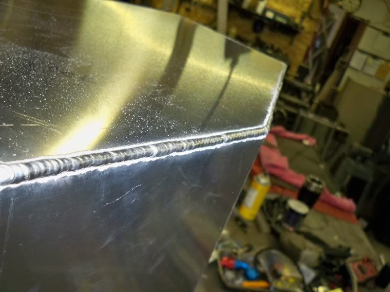

some weld. remember i am still teaching myself AL welding, so its not the best thing ever, but i am still fairly impressed with myself.
http://i94.photobucket.com/albums/l8...15/m715347.jpg

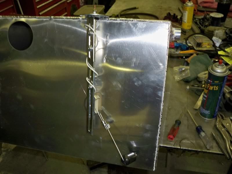

generic adjustable NAPA sending unit.
http://i94.photobucket.com/albums/l8...15/m715351.jpg
installed.
http://i94.photobucket.com/albums/l8...15/m715353.jpg
