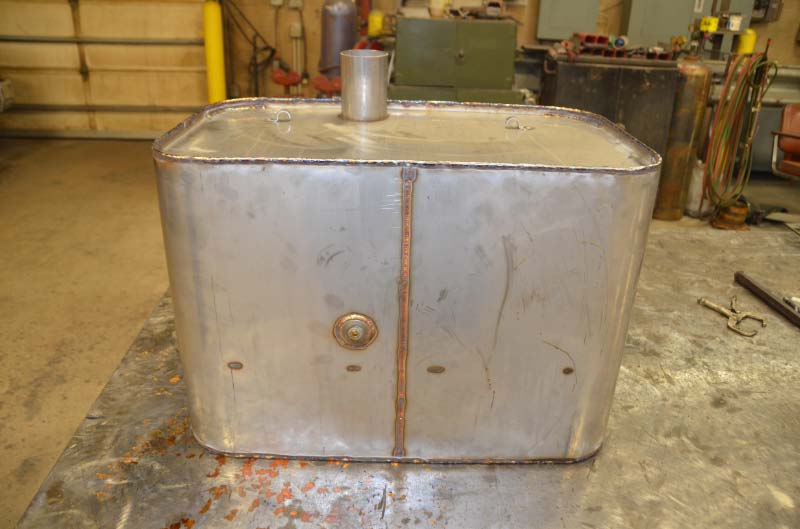

I'm looking at modifications to my aluminum tank at the moment - drawing from racecar fuel cell concepts (and parts of which that I have in my toolbox and around the shop)
I may go with a surge tank instead of reproducing the baffle, and am considering an electronic sender over the swinging-arm style...
We'll see.
