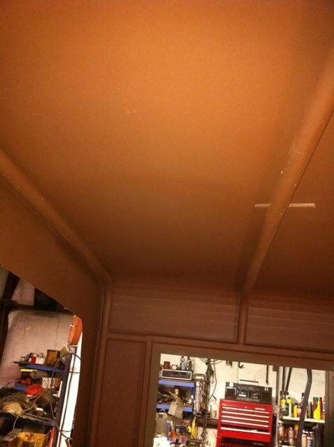

http://i1297.photobucket.com/albums/...psc27f1594.jpg
The inside view, I left the OEM frame and used automotive caulk between the roof and the pipes. I didn't want to damage or weld to the frames.
http://i1297.photobucket.com/albums/...ps91135620.jpg
The oustide is skip welded to the cab of the truck. The main roof is from drip channel across the top to the over side drip channel. I then welded the little vertical side plates in.
I installed a rearwindow with sliding glass (aka..beer window)from a Toyota truck.
Made it from 14 ga sheetmetal and used the windsheild frame for a template for the raduis. Add a little extra room around the windshield so that it will clear when you open/close it.
If you look at the front right corner you will see a squre tubing support that helps hold the roof. It's welded to a flatbar frame that goes across even with the top of the windshield frame for a seal. And the sq. tubing bolts to the dashboard. Hope this helps? I will look for more photo's. Sorry about the last photo its rotated wrong!:eek:
