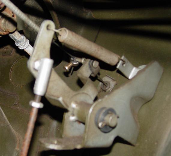

http://img294.imageshack.us/img294/802/m715001io2.jpg
jfnemt1ff1 :
Re: Hand Throttle?
Post by jfnemt1ff1 on Nov 8, 2006, 1:21pm
http://img72.imageshack.us/img72/617/m715002bm8.jpg
Here is the set up in my 725

Heres a few shots of mine:
A little to the left of straight on:
http://www.m715zone.com/jonmisc/hand_throttle1.jpg
You can see the cable coming from the dash on the upper left back the the pin with the phillips screw right behind it...that is the setup...easy really to do....
Straight on:
http://www.m715zone.com/jonmisc/hand_throttle2.jpg
The pin goes through the linkage arm and has a cotter pin to keep it from backing out...then the cable goes through the hole down the other end of the pin...the screw goes into a block that the cable passes through and is used to adjust the tension.
From the passenger side:
http://www.m715zone.com/jonmisc/hand_throttle3.jpg
You ca see the mounting pin at the back and also the U shaped piece that goes on the pin and around the arm to mount the throttle cable to the carb.
