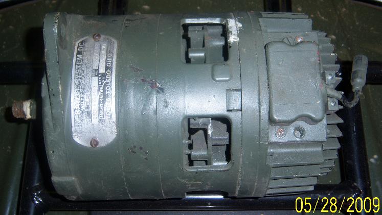

Here is my Prestolite:
Overal view:
http://www.m715zone.com/jonmisc/prest_alt1.jpg

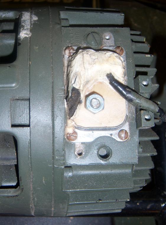

Close up under the wire cover area:
http://www.m715zone.com/jonmisc/prest_alt2.jpg
If you look at the large OD flat head screw at the top of the pic, just to the left of that it says:
VOLTS
NCR
Not sure what that means.

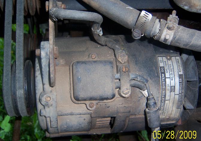

Here is a shot of the Leece Neville unit in my truck...reason I am posting this is to show where the ground wire mounts to the alternator mount bracket:
http://www.m715zone.com/jonmisc/leece_alt.jpg
Oh, you can see the ground wire mount on the Prestolite unit just below the wire cover in the first pic and a little below the stud with the nut in the 2nd.
Thanks brute4c. got it running today seems to be working properly. where the epoxy is on yours is about where my second stud is. thanks again for all your help!

2 wires in and 1 coming out...a stud underneath...wonder if I cleaned theat stuff out if I would find all the wires hooked to that stud as the connector...
