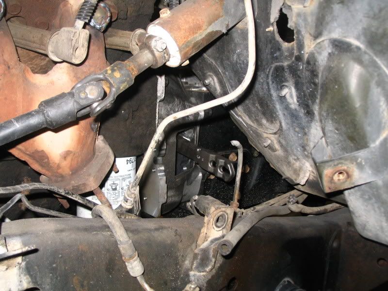

received the advance adapters bellhousing and my u-bolts from Alcan. started to pull the trans on thursday and got stricken down by a case of the stomach flu. had to call in on friday... first time in my professional carreer that i have had to call in sick. but i felt better today and spent a few hours at the shop. got the tranny back in and got the belly pan welded up. thankfully it held its dimension perfectly and was not a problem. so now the truck is ready for me to set the rear pinion angle.
next on the list are driveshafts, rear gears, front axle swap, and wiring. it also looks like i will have to build myself a new fuel tank to keep the driveshaft out of it. not for sure yet
a few pics of the new stuff
bell housing is all shiney and new
http://i94.photobucket.com/albums/l8...15/m715233.jpg
clutch fork is where it ought to be. ordered the slave cylinder braket from AA last week. was going to make one, but it was only 24 bucks, so i just hit the Buy It Now button

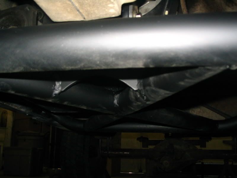

welded the underbelly and painted it

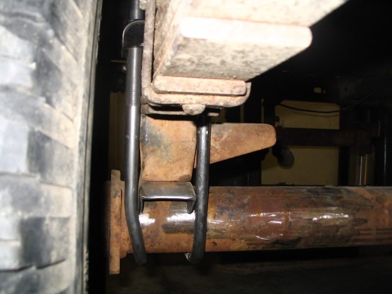

had to finagle the u bolts to make them work

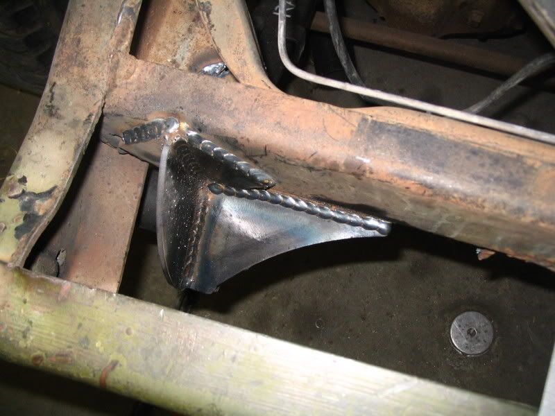

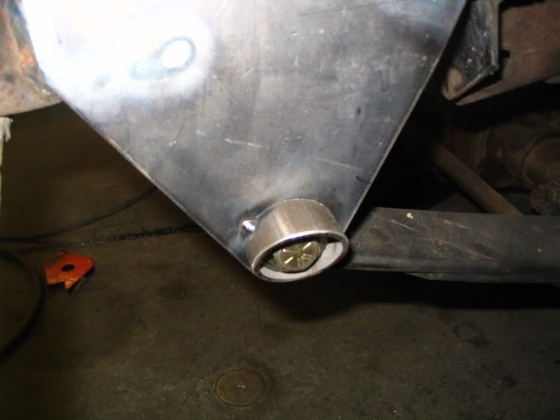

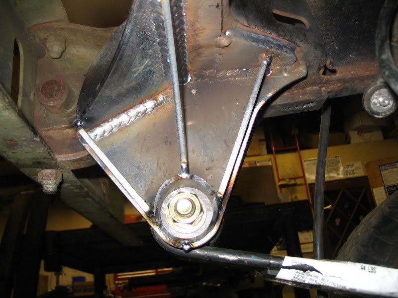

did some work gusseting the spring hangers tonight.
http://i94.photobucket.com/albums/l8...15/m715238.jpg
drivers side
http://i94.photobucket.com/albums/l8...15/m715239.jpg
passengers side
http://i94.photobucket.com/albums/l8...15/m715240.jpg
put these little tube angles over the bolthead/nut to have something to land on

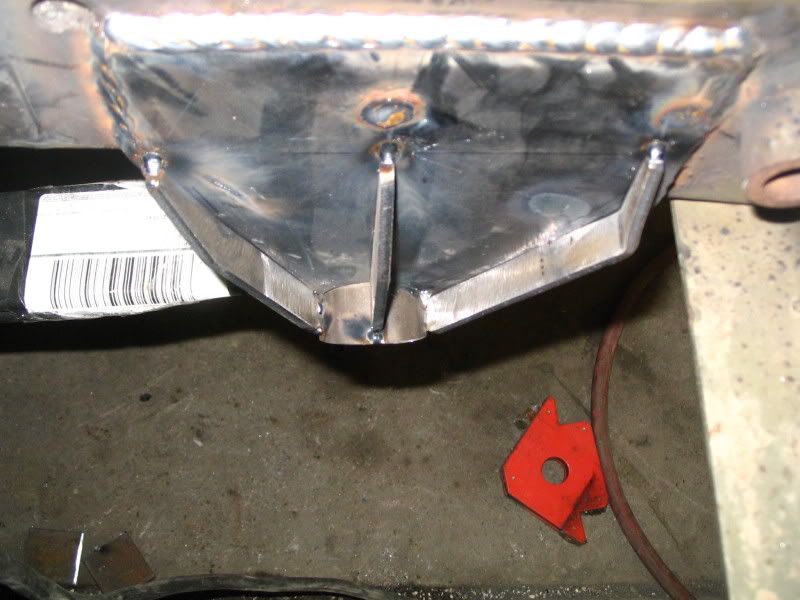

http://i94.photobucket.com/albums/l8...15/m715243.jpg
added some dimension to the outer plates
http://i94.photobucket.com/albums/l8...15/m715245.jpg
http://i94.photobucket.com/albums/l8...15/m715247.jpg
shot from the front
http://i94.photobucket.com/albums/l8...15/m715242.jpg
ryan
I cant cut the metal pieces that well let alone put the thing together....amazing work Ryan!!
I've said it once and I'll say it again, you sir, are a professional! Outstanding work!
Looking great, but be very careful with the tack-tack-tack welding style.
thanks Jon, Randy, and Mikel
For what its worth Mikel, i don't stack tacks. that is a continuos (sp?) weld. just a tecnique used to give that stacked look. i am more than confident that something else will fail long before the welds break
