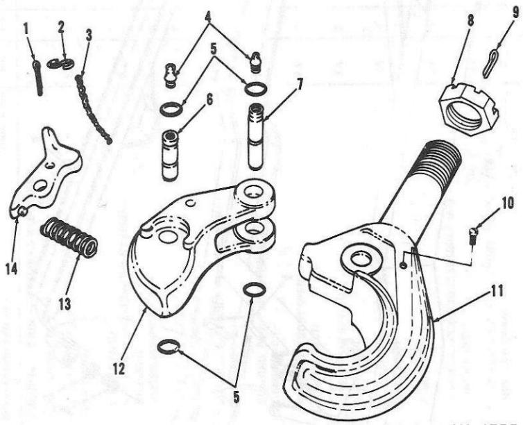

I need to clean this hitch thoroughly. I got the shaft cleaned up enough but cannot figure out how the jaw pins get removed.
I found this picture to help describe what I'm looking at:
http://www.m715zone.com/jonmisc/fig92.jpg
I need to remove number 5 from pins 6 and 7 but don't see how this happens. They appear to be a continuous ring. Anyone have any insight?
Also anyone know how to remove rivet 10?
Just in case someone else stumbles upon this I figured out the number 5 clips are spring clips. I haven't figured out what the proper name for them is though. Once I got enough rust out of the way I was able to see where I could pry to unwrap the spring clip from the pin.
