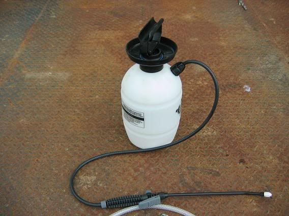

The tank

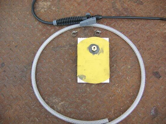

The hose and fittings
http://img.photobucket.com/albums/v7.../68M715049.jpg

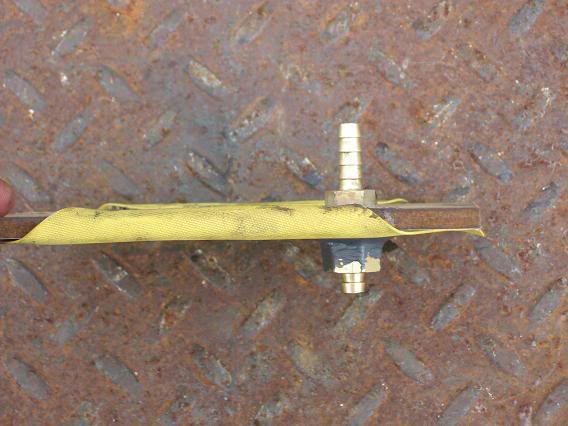

A look at the cover
http://img.photobucket.com/albums/v7.../68M715050.jpg
http://img.photobucket.com/albums/v7.../68M715051.jpg

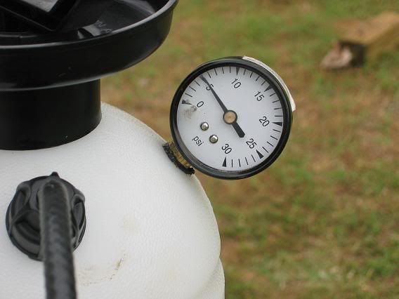

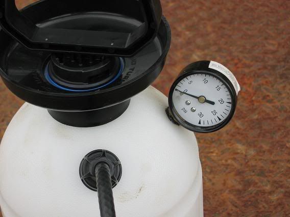

I added a pressure gauge and used RTV to seal it

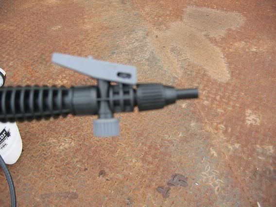

I cut off the majority of the wand and attached the hose with a hose clamp.
