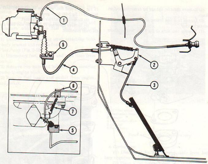

A little while back, my stock linkage broke. I was going to fix it, but all the pieces got lost. So, my question is, what should I do for throttle linkage? All of it is MIA.:gasman:
What all exactly are you missing?
http://www.m715zone.com/jonmisc/fig2-19.jpg
I know the throttle cables and the pin it hooks to at the gas pedal end are available from Memphis...and probably other places.
Saturn has #3 I think.
Stock engine? or something else?
unless you're going for "all stock" I'd swap to Wag/Cherokee stuff. Find a junker and rob it all, pay attention to how it came out and put it in the same. You'll need to relocate the hole the cable passes through in the firewall and drill some holes to mount the foot pedal as it is different than the M715 (better IMO).
I did it and am real happy with it.
I have the stock engine. I am missing the cable and the little ball thing that snaps on the carb, as well as the part that attaches the cable to the pedal.
Should all be available from Memphis and some from other suppliers...
