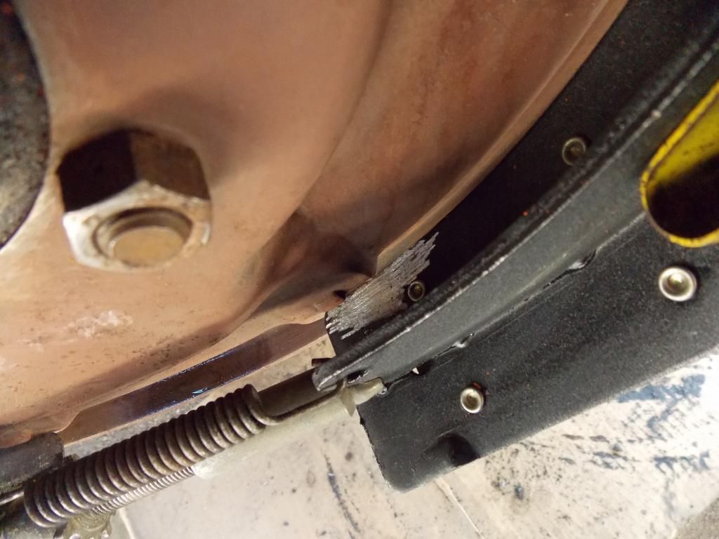

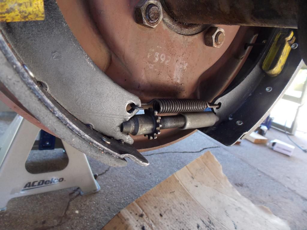

The Star Adjuster on the Drivers side faces Forward.
The Star Adjuster on the Pass Side Faces Rearward.
http://i1279.photobucket.com/albums/...pse193444b.jpg

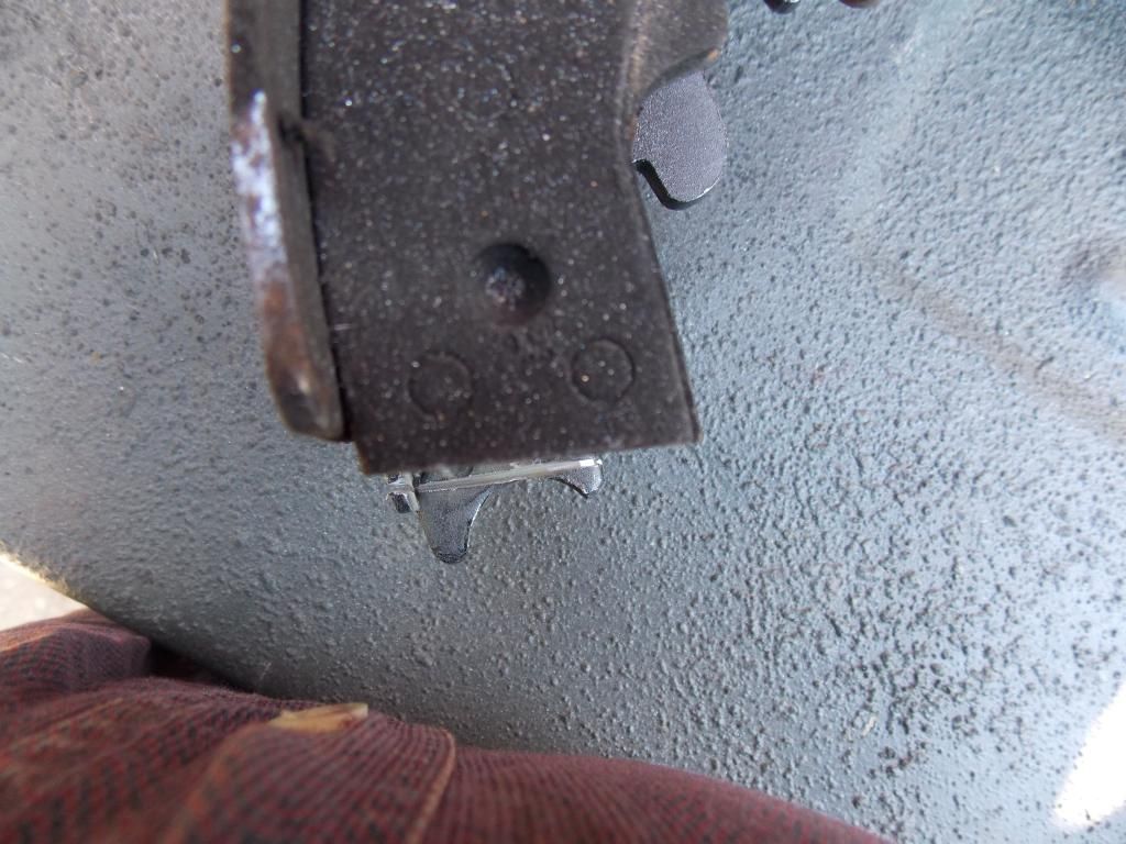

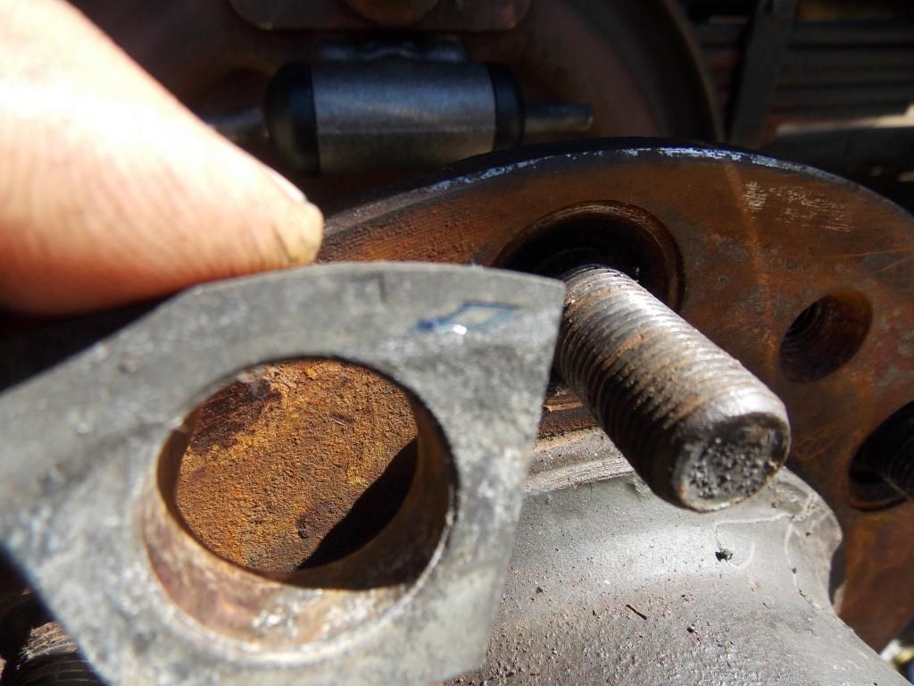

If Your Brakes or wheel cylinders look like this.....
Houston... We have a Problem.
http://i1279.photobucket.com/albums/...psee165697.jpg
http://i1279.photobucket.com/albums/...ps9bf3de78.jpg

anchor the bottom of a New Spring into the anchor hole in the Primary Shoe. Stretch the PRIMARY SHOE SPRING FIRST, and anchor it over the center anchor stud, so it is the closest spring to the wheel cylinder.
Take a screwdriver, and position the anchor plate so it is centered on the stud.
Repeat for the Secondary Shoe ( back shoe ), placing this spring end OVER the first spring.
Passenger side spring placement:
[URL=http://s1279.photobucket.com/user/Blitz777/media/Brakes062_zps041fb00a.jpg.html]
Make sure everything is centered on the brake backing plate, the anchor points, pins, and that the steel of the shoes is sitting properly on the brake backing plate.
[URL=http://s1279.photobucket.com/user/Blitz777/media/Brakes063_zps096de7a7.jpg.html]
Drivers side:
[URL=http://s1279.photobucket.com/user/Blitz777/media/Brakes006_zpscaa5be32.jpg.html]
Clean and exercise the star adjuster assembly.
For the drivers side, the star goes forward.
The Passenger side, the star goes rearward.
Install the star adjuster between the bottom of the brake shoes, and tighten slightly to hold it in place.
Install the old return spring that you saved and cleaned, onto the bottom of the two brake shoes.
[URL=http://s1279.photobucket.com/user/Blitz777/media/Brakes012_zpse193444b.jpg.html]
By turning the star adjuster toward the ground, the brakes will expand and get tighter.
Opposite, turning the star UP will loosen the brakes.
Adjust the brakes up until the drum just slips over the shoes.
Spin the drum by hand a few times, and a little drag here is ok for now.
Do the same for the other side.
